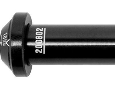

Posts: 1103
Stealth axles usually have writing on the head so once torqued correctly just remember how it lines up, for example the B of my Burgtec one is at 2 o clock.
With QR everyone has a different definition of just right tight.
