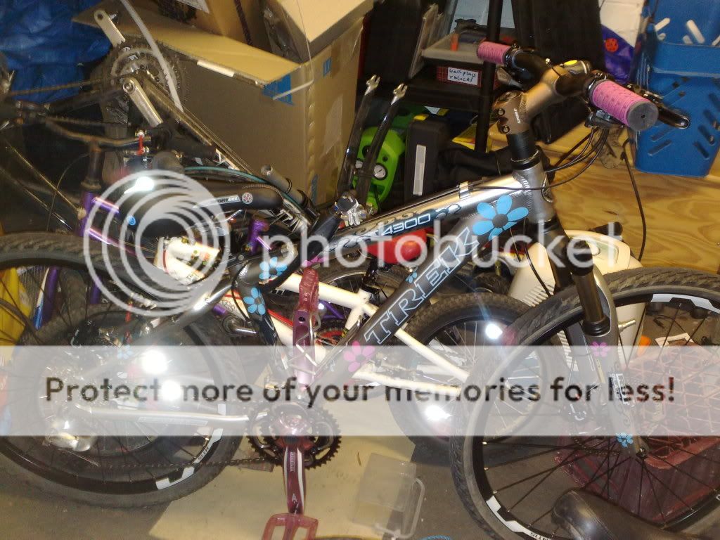

Posts: 396
a 24" wheel trek frame that i bought off the classifieds with an rst front fork and 26" wheel - some new bars, sorted the well used brakes and gears and some stickers - great bike
now has a 14" trek frame off here which i've build up but with nice pink chain set and hydraulic disks - I'll have to look for a picture though
Posted : 21/04/2011 9:50 pm

Posts: 396
think the pink chainset is aerodyne and widely thought to be a kind of cheese but the girl likes it, trek frame and most bits of the classifieds except shimano hydraulic disks because i'd rather fit and forget - fed up with sorting kids brakes
