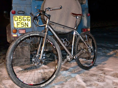

thats how mines looked when i built it.

Posts: 39668
on an alfine youll be fine i would think
but with a rohloff its not just a case of fitting a tensioner and everything else will work.
ill go find pictures.
Posted : 23/06/2013 9:51 am
Posts: 39668
if the disk mounts like that you could get away with that - but i wouldnt be surprised if you did see a failure in the bonding - as ben says they will likely be fine but the constant cycling might see failure long before it would have done with just the braking forces acting on it.
If you can get it - a drop out similar to this is imo the best option for rohloffs no ****ing the dog putting the wheel in and out - drop it in , screw on click box and go. It is for me the major reason i still have my rohloff instead of my alfine ๐Ÿ˜€

[img] [/img]What is that lever jubilee clipped to the stay?

That long lever is the torque arm - it's used on frames which have neither a Rohloff-specific dropout, or a disc mount. Clamping that to a carbon stay would in all likelihood be perfectly okay - carbon is much stronger than you think - but would be sub-optimal.
If the frame has an IS disc mount, then you can use the Speedbone onto that instead, and I've never, ever heard of a problem with that on a carbon frame. If a carbon frame was so weak that relatively small loads through the disc mount caused it to fail, you've got bigger problems.

@trail_rat. That pic of the Surly - did you have to unbolt the disc mount to remove the wheel? Just fitting a Speed hub to a Krampus - same dropouts I think.
Posted : 23/06/2013 6:49 pm
Posts: 39668
looks that way - its not mine i have no idea , tbh i was looking for a speedbone mounting and missread that picture on my phone ... i would reckon he has to remove that bolt. doesnt seem like the most clever fitment to me.

no way round it tho' it looks like :o(
Posted : 24/06/2013 11:48 am
No, that's a Monkeybone caliper adaptor - the OEM2 mount slots into it a bit like a Speedbone. So you don't need to unbolt anything.
