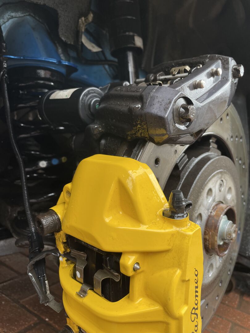

All my "good" vehicles have / had Brembo brakes. I wouldn't let them near a bicycle.
Also for the company that invented the monoblock calliper to be making a split MTB calliper seems a bit odd. Is it actually theirs?
IIRC Shimano dropped the one-piece design when they found that two part calipers were substantially stiffer?
I'm guessing there's probably a difference there between a tiny little bike caliper and the big chunky things on cars.

2 piece calipers have long steel bolts holding them together.
I'm no engineer but it's not hard to imagine that's a stiffer setup than a block of alloy with the guts milled out then sliced almost in half.
Especially at tiny MTB caliper sizes.

You're not an engineer.
Those steel bolts are about 3x stiffer than the aluminum they replace, which is a significant amount of the caliper in tiny MTB calipers.
Compared to the huge Monoblock calipers made for cars where the caliper is almost closed at the ends because it's so much bigger than the disk.

Anyone extolling Brembo’s engineering prowess has clearly never had to work on their kit. They’ve been using the same abysmal pad retention pins for donkey’s years. They’re held in with a crimped metal olive that expands into a detent in the back of the calliper. The callipers are aluminium (mag on fezzas and motorbikes) the pins are sometimes stainless, sometimes zinc passivated, the olives are mild steel. It’s all pretty much a press fit (mel’d into place by a gorilla). Obviously there’s no rain or salt in Turin because the inevitable happens when you use them here
They sell a bendy metal tool to pull them out from the back. What you actually need is a reverse conical drift and a 2kg lump hammer. I’ve even had to use an SDS breaker on one it was so seized. It’s a truly shit design, everyone in motorsport hates it and yet they persist belligerently, fitting them to anything from minis to Ferraris. It’s up there with Magura’s motorbike clutch slave for invoking the feeling of “you’d want to insert it into the designer’s rectum in vengeance”
