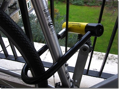

Posts: 39918
but when your website(london cyclist) shows such great locking techniques such as that above its hard to take them seriously !

Posts: 34823

Posts: 39918
quicker to cut the item its locked to than the lock - bike in the van and away.
best lock in the world is only as strong as the item its locked too
Posted : 08/05/2012 11:02 am
Funniest thing about that picture is it is not even the strongest bit of railing in the picute!! They could have even put the lock round two of the thinner bits.

Posts: 6859
Yeah the picture isn't very clever considering there's a thicker bit of railing merely centimetres away, but I can't imagine even the thinner bit of railing would be particularly breakable. And because of the low down positioning and lack of space 'inside' the D, there's no easy way to get a jack-type tool in there.

Posts: 14724
ffs, I've no idea where the lock photo comes from on that site, but shirely the point of it is to show the frame & wheel being locked to a secure object. The fact that it isn't the most secure piece of street furniture in the world is irrelevent.
Just get back to the OP's question rather than tie this up due to your pedant-ism.
