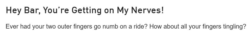

Those gloves btw: https://www.specialized.com/us/en/mens-body-geometry-sport-gel-long-finger-gloves/p/156925?color=248780-156925
...and from the product page:
