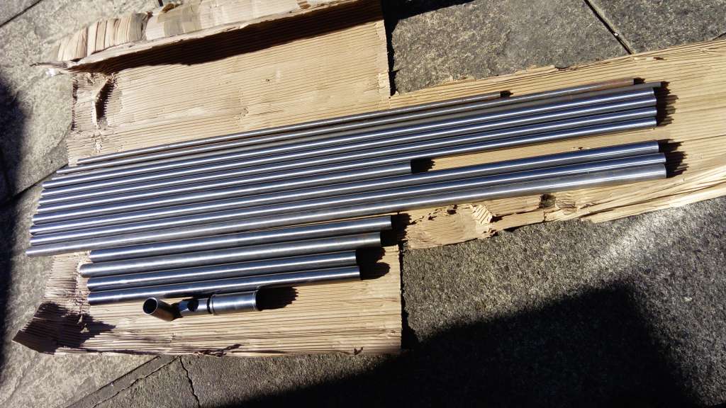

Posts: 3666
I prefer cooking from scratch
DSC_0411
