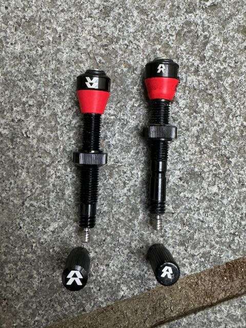

and the cheap Chinese ones turned out to be fakes.  Got around to fitting them and, unlike the genuine ones there was an 'unthreaded' bit part way down the body, but more significantly the caps wouldn't stay on.  And the printing on them wasn't as sharp as on the real ones.  Amazing the stuff that gets copied now - would not have thought it would be worth setting up a production line for something as niche as this, even more so if you're going to screw it up.

Swapped out the fake fillmores for real ones (picked up a few sets for £25 Black Friday)  today - here they are side by side. Fakes on the right.
off centre printing on the cap.  Cap didn't screw onto the shaft - I think the threads inside the cap just disintegrated.  The longer smooth section meant I'd had trouble trying to connect my tubeless inflater (and one of my track pumps) to it.  I've no idea what the production line is for something like this, but still amazed it's worth trying to fake (even more so if you screw it up and it doesn't work)

The fake one looks like a V1 Fillmore as they had that longer smooth top section.
hmm.  the thing that makes the fakes useless is that the cap won't fit.  Other than the slightly off printing the rest of it seems functionally sound and (other than shape) indistinguishable from the real.
