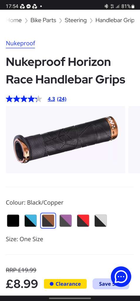

If you want to try some different hand positions on the bars (width wise) try a pair of these, they are the longest grips I've ever had. You can easily move your hands an inch inboard and still be on the grips. Cheaper than experimenting trimming your bars
Screenshot_20231114_175422_Chrome
