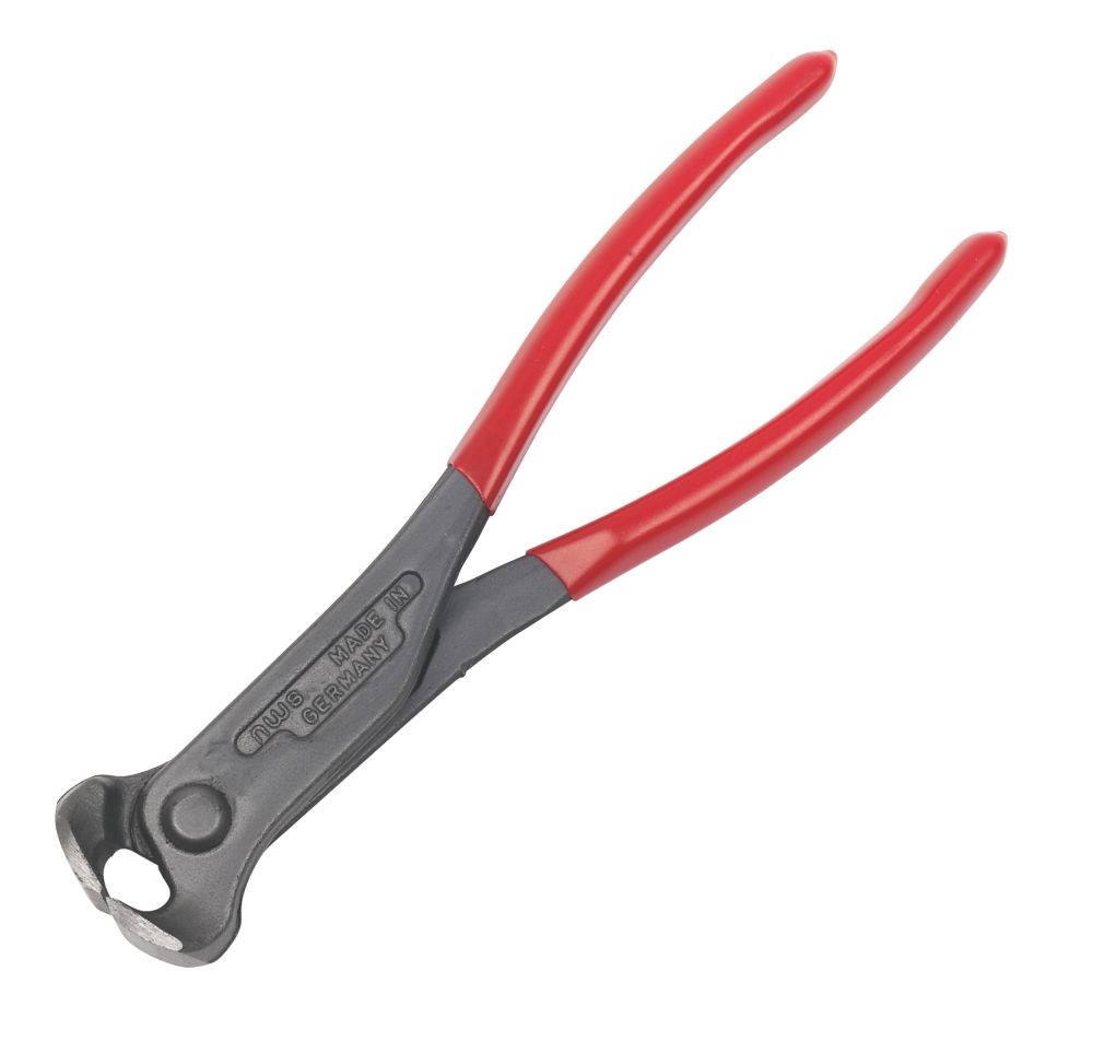

Posts: 42157
End cutters.
There's a tool for every job etc.
[img] http://s7g3.scene7.com/is/image/ae235?$p$&layer=0&size=281,281&layer=1&size=281,281&src=ae235/91523_P [/img]
Also good for cutting gear cables as they're so over-engineered for that job they go through them like butter.
