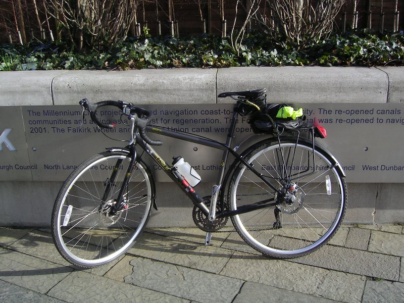

I had this issue with a set of P2 forks. I cut one of the mudguard stays off, so that there's now only one stay (plus the bit under the headtube). I've been running it like this for 3 years......
You might just be able to make it out in this photo
Posted : 03/02/2010 11:36 pm

Thanks guys and I see what you mean by the pic.
