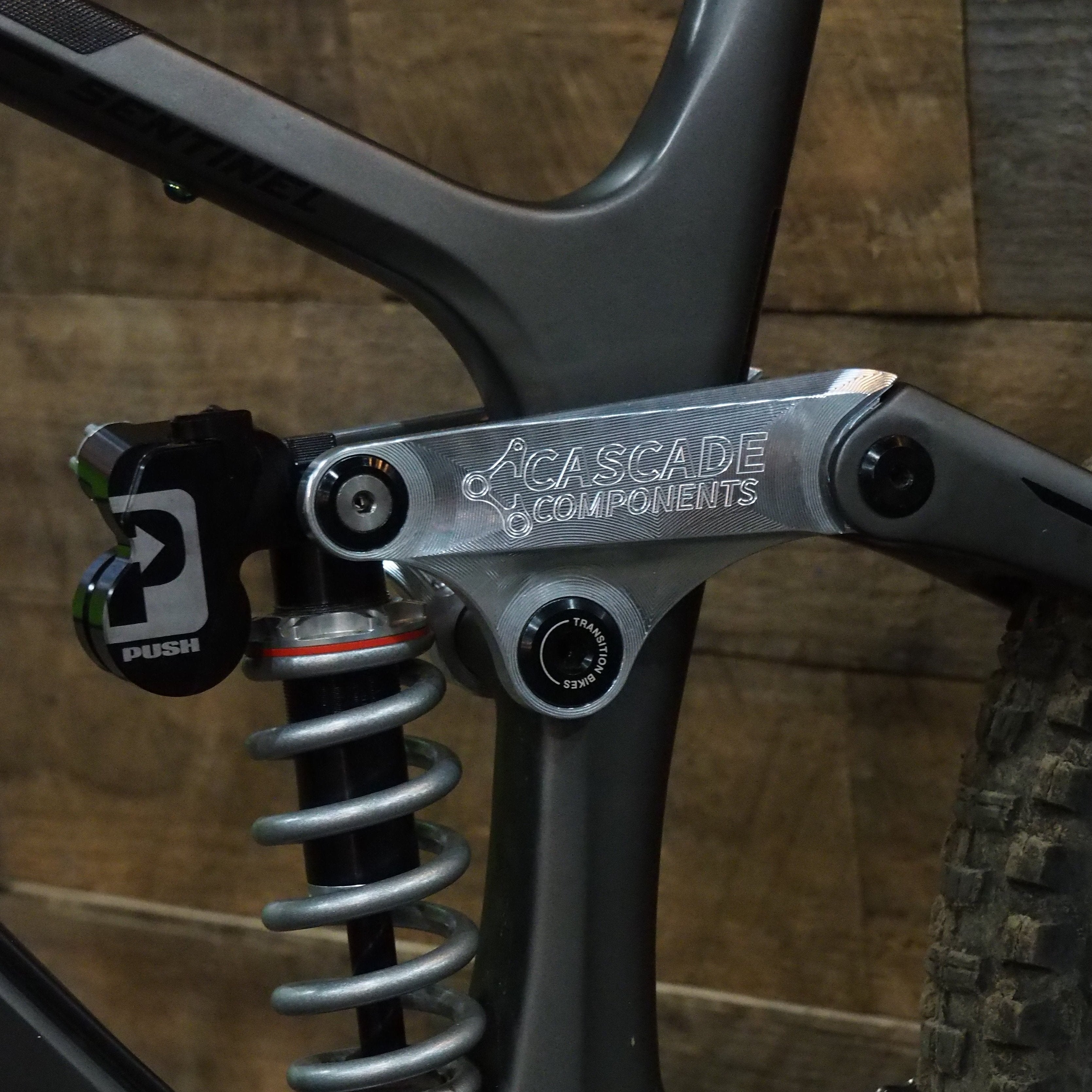

Posts: 822
Cascade link and a coil would be my pick for beefing up a sentinel. IME if you're over ~80ish kg you'll really notice the stiffness of a zeb but the damping and +10mm travel isn't that noticeable.

Posts: 123
I had a V1 Sentinel, as did a good friend, we both got cascade links and both thought they really improved the bike. We both now have Spires!
I'd suggest get the cascade link first and then some 170 forks

Posts: 10251
I’ve got a v2 Sentinel - running 160mm lyriks and a Vivid Coil and Cascade link on the back.
I found I blew through the travel when I put a coil shock on with the standard linkage (Cane Creek Kitsuma). The Cascade link really helped - but also I really like the Vivid coil. Less adjustments than the Kitsuma but they make more difference - and the HBO means you can get away with a lighter spring for a more plush feel but without having any heavy bottom outs.
As I’m only running 160mm up front I’m running the Cascade link with a shorter stroke than standard so I have about 155mm travel at the rear. But if you are running 170mm Zebs / 38s then running  the Cascade link with the normal stroke length shock gets you to 165mm travel. I reckon that would be awesome on park days.
