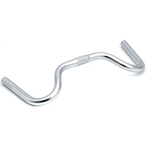

Hmm, what are those bars Epicyclo?

13thfloormonk
Hmm, what are those bars...?
Satori Minotaurs, aka Smooth `Drop, aka Bullbar. Also sold by One23.
PlanetX were selling Nitto bars that look identical, and at a much better price than I paid for mine. I just checked - they're sold out now.  http://www.planetx.co.uk/i/q/HBNIB307/nitto-b307-commuter-handlebar
Their advantage was they have the right diameter to take mtb levers, so they're handy for anything being converted for gravel that uses mtb controls. They also work equally well the other way up. They're very much like the traditional bars used by our grandparents when most roads were gravel. Up for weekday commuting, down for the weekend.

Massive bump, but finally ordered some Nitto B307s for my Superfly CX/Gravel franken-MTB, £33 and free postage from Japan, although 30 day delivery!
https://www.ebay.co.uk/itm/NITTO-Nitto-B307AA-25-4-SILVER-435-handle-bar/283031130163?epid=1861249699&hash=item41e5f85033:g:-kAAAOSwUPZbNbQo
Just need to find the least ugly 40 degree, 90mm, 25.4mm clamp stem on the market (SJS Cycles to the rescue I think!) and I'll end up with a few more useful hand positions, and better yet, might get a few less comments on the CX course about my stubby chopped down flat bars (instead, all comments about the gopping stem I suspect...).
