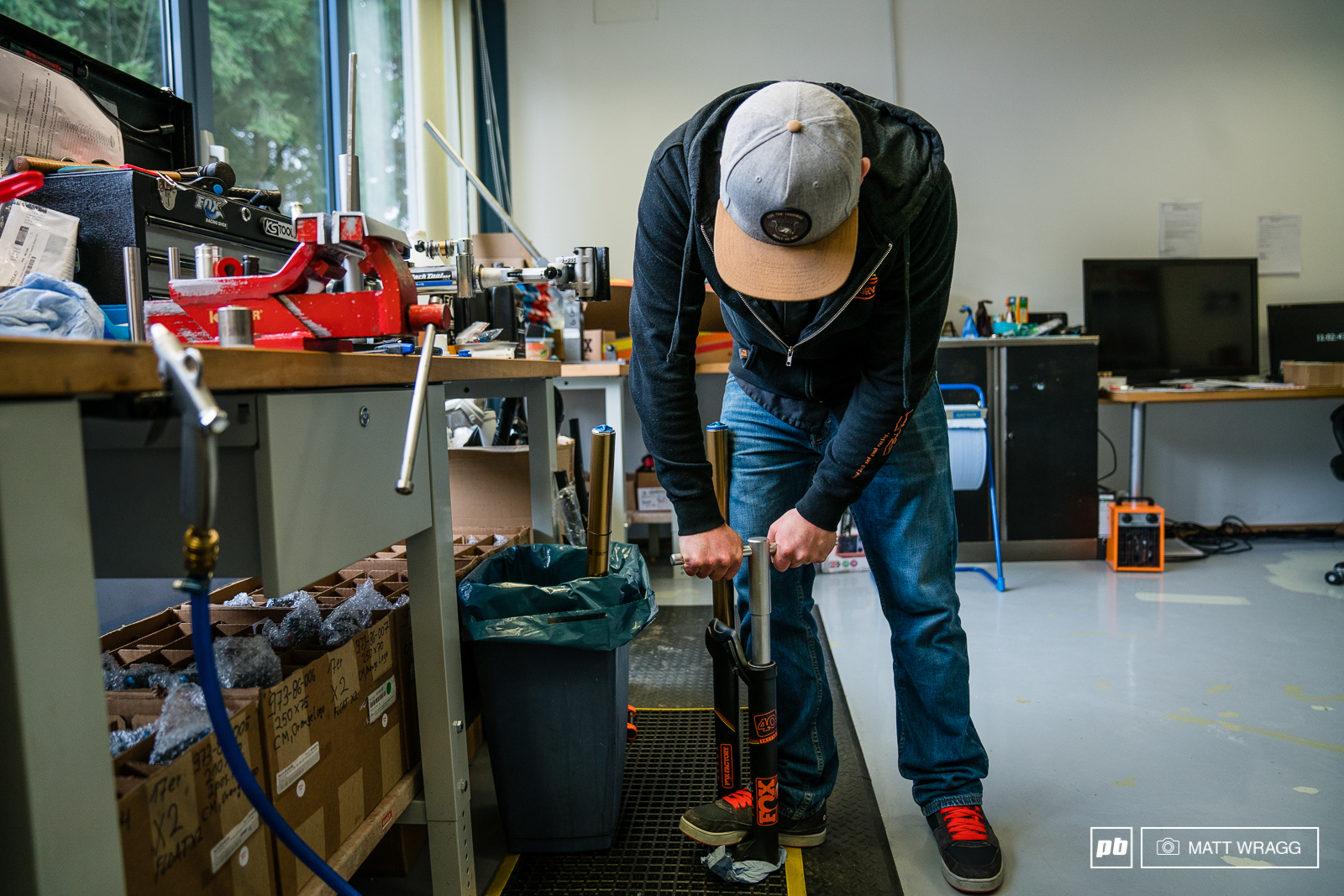

Have a look at this
http://m.pinkbike.com/news/race-prepping-a-fox-40.html
Everything is standard off the shelf in there, opening up the bushings etc is one of this fast bed in tricks really like them spinning the santa Cruz hubs and bbs on a drill
Posted : 18/02/2017 8:14 am

[quote=mikewsmith ]Have a look at this
[b]With the stanchion carefully set aside[/b], Kolja does one of the things that he says makes the biggest difference to the feel of the fork—he works the bushings.
Aye tossed in the bin 😆
