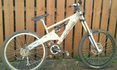

OK, an Orange 222 with a 2009 Boxxer on it has come up for £430 delivered. Looks like I'm going for it!

I've got a 222 with Boxxer Team 04's (bit of inspiration for you to buy one!)

[b]@ Herman Shake[/b]
Looks a good bike from here - but there are a few things you can do, to bring it more in-line with 'modern' DH bikes.
For starters, bring the front end down! Low-rise top crown, and low rise bars (I paid £30 for some flat 780mm bars). The change in handling is very noticeable!
On that 222 is a Vanilla RC shock - very basic - but very reliable (I have Patriot '00 frame, and the RC shock that came with it used daily!). My shock is a DHX 5.0, picked up for around £80 back in 2009.
Chain device - first thing I would change, as that "MRP Copy" is shockingly bad (speaking from experience...). £25 on STW got me a Superstar Laser chain guide (above, in black)
Only major difference between ours, is your swingarm spacing is 135x12mm, and the brake bolts directly onto the swingarm. Mine's got a floating IBS arm, and can only use 2 types of hub (Hope Bulb, Sun Ringle).
In total, I think mine cost around £500 (when older parts have been sold and upgraded). Only gets used a handful of times per year, but I'm not changing it!!
And you do feel a sense of British pride riding an Orange, with Hope brakes and a loud clicky Hope hub... (We have 3 Hope equipped Oranges in the house..)

Ah, I'd heard (read) about the brake jack on these. I guess that's why they have the IBS, an unfortunate acronym though! Irritable brake syndrome?
Can a direct mount stem be flipped, faceplate corrected of course? I've no experience of them but obviously get the fundamental difference.
I did think the chain device looked a bit heavy dooty with the top roller a little redundant. The rear mech cable is a little generous too 😯

Stem *might* be able to flip - only if it's designed to do so. A handful of stems on the market could do so, enabling 'negative rise' (to get the front end loooooow)
This SS one is on offer @ £28 -> http://superstar.tibolts.co.uk/product_info.php?cPath=67&products_id=460 (Just been notified by another forum of the offer).
Shoot me an email (in profile) if you want any more info, instead of cluttering up this thread?
FWIW, I managed to get the weight down to 31 lb, with reasonably strong components. Damn good weight for an old DH sledge!

Have a browse to see the developments of mine - http://xiphon.pinkbike.com/album/222/
Started off as a tank (read: cheap to build!), then slowly progressed into a respectable race spec.
