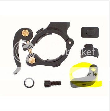

Richmtb, have you tried it with the hope helmet mount? It'd be ace if that worked, I'm looking at one to compliment my vision 4
See the small piece I've highlighted, that should screw onto the lamp body. You can then mount this on your hope helmet mount (I've not tried it but no reason why it shouldn't work)

Ooh, mine has just arrived. Looks really well made for the price. Going to try it on my Hope helmet mount to compliment my Trouted Vision 4 on the bars 🙂
