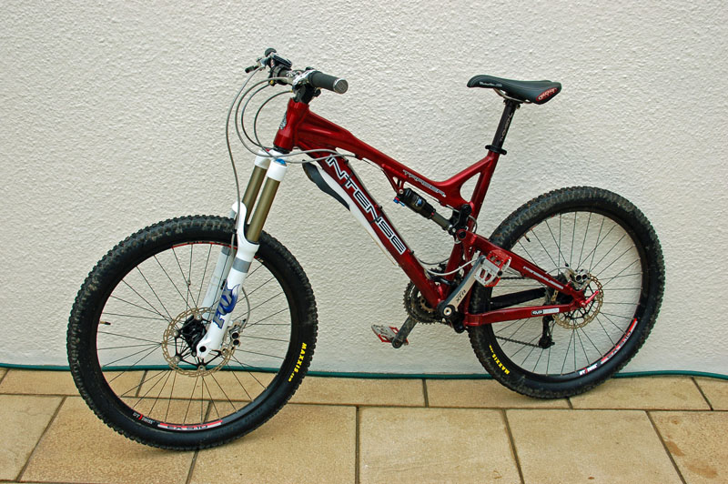

Just back from an Alps trip and 2 of our group had Tracers. Both running it in 6 inch mode with Fox 36 Talas forks. I asked them what the point of just half an inch difference in travel adjustment was and they said it alters the geometry quite a bit, enough to make it much more racey feeling especially with the forks wound down to 130mm. Very nice looking bikes as you can see.

Ive had my Tracer since just before Christmas, I cant see past it.
At first I ran it on pikes, Then I came into possession of a pair Lyrics. It took me a bit of fettling to get the rear shock sorted out and the correct headset that suited me, but now I have the balance just perfect and I'm loving this machine. Fast flowy single track, rocky rooty downs, technical climbs it doesn't matter what you through at it just eats it up and alway puts a smile on my ugly mug.
The headset stack hight is something to look out for on The Tracer
I'm running a 1.5 steerer, at first I ran a cane creek double x headset but it just made the frame feel to slack and became a disaster on the climbs. so I tried out a Crank bro set, with it's lower stack it did the trick and I'm now not pulling wheelies on the climbs.

I've had mine since January, and absolutely love it.
Like Craig, I originally ran it with Pikes. With my Hope 1.5" stepdown headset this made the steering very quick and it felt too steep when descending. I replaced the Pikes with 36 Floats and the bike is much more composed. It rides very light and I find I can throw it around quite easily.
The rear shock setup is something that alot of people seem to have trouble with (me included). I weigh 15 stone and find that I blow through the mid-stroke of the RP23 very easily. On advice from Mojo I made a shim to go in the High Volume section of the can to 'ramp' up the end of the stroke and still retain the small bump compliance. This has improved it but I am going to see what TFT can do.

fozzybear - when I first got my Tracer I was running the pikes with a 0 stack headset 1.5 step-down, the cane creek one, I never got on with it, the front end felt a bit twitchy on the downs, so I soon changed It to a Cane Creek Double X which totally sorted things out up front, with its bigger stack it made the frame feel much stabler going down the way.
When I got the Lyrics I had the opposite problem but with the added problem of the steerer being a 1.5, this limited me to what headsets i could install, as I said above with a cane creek double x set it just felt to slack and a night mare climbing up techy stuff. So after a lot of scratching about I finally got the Crank Brothers 1.5 Sage headset, which totally sorted things out, so I'm well happy now.
If you opt for a 6" travel fork I reckon it might be a good idea to go for a 1-1/8 steerer as It gives you more options on what headsets you can use.
At first I wasn't sure if I should put a 6" travel fork on the Tracer but as soon as I did and got things feeling dialled, It defo becomes a different beast, much much better IMO
I don't feel that there is any issues with the rear shock but that might just be to do with my Lack of experience on such things.
