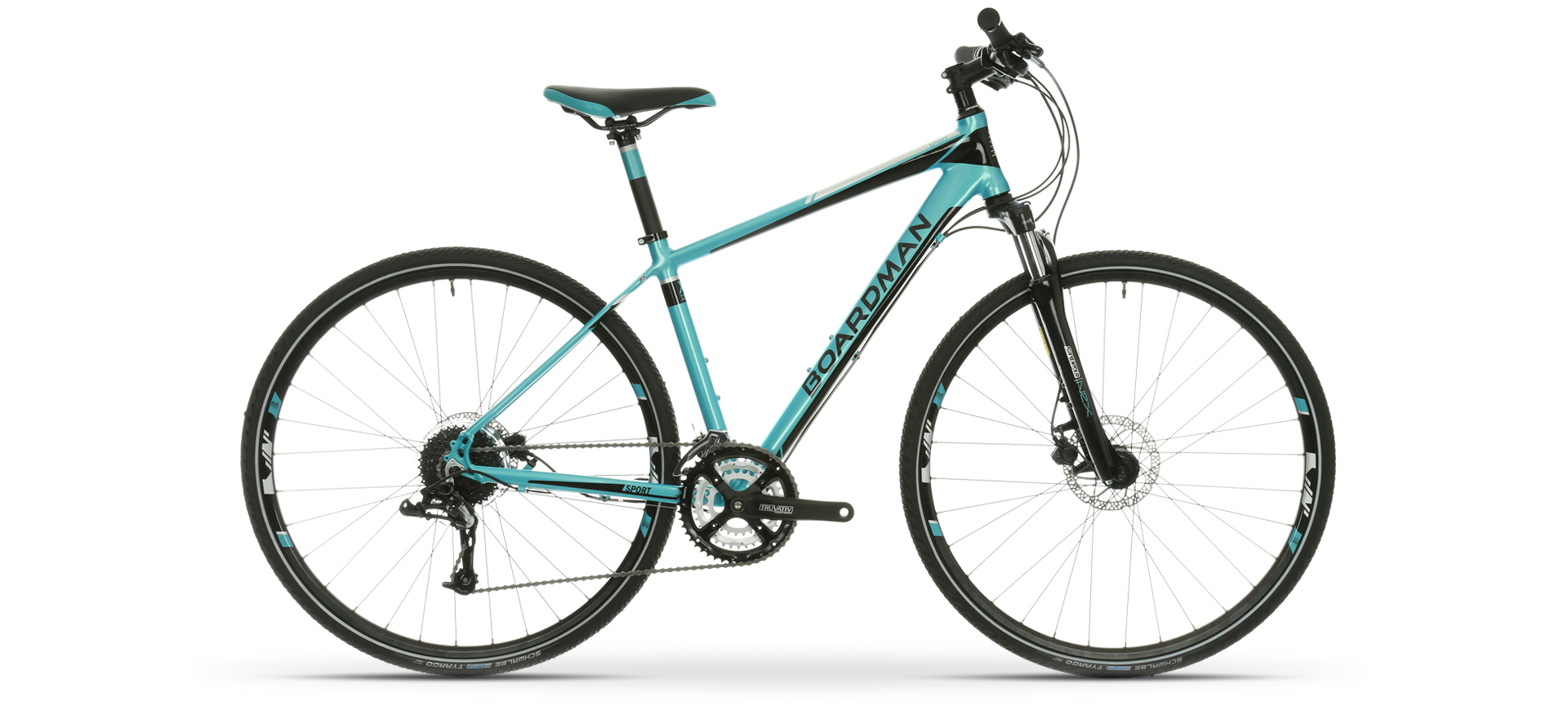

I think I've convinced myself now that 29" is ok. This is from Boardman bikes, the Mx Sport
An MTB leaning hybrid, which is pretty much what I had in my head.
