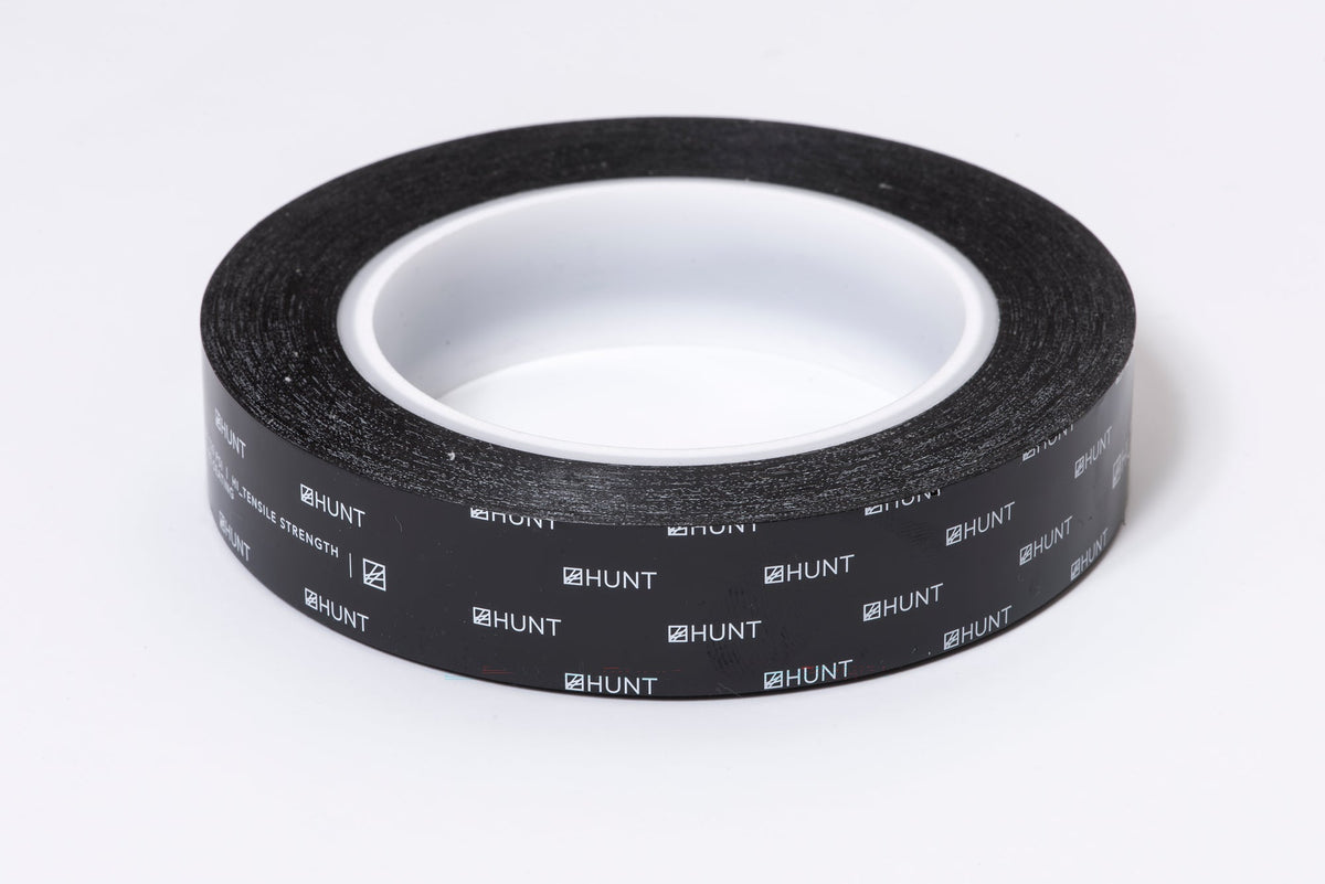

You need wider than the internal cavity width. On a 25mm internal rim, 27mm is the idea width of tape…
Useful chart here on Hunt’s site to help…
https://www.huntbikewheels.com/products/hunt-blackshield-tubeless-rim-tape?variant=12743994441805
Hope that helps.

Cheers for link mboy 👍
Need to try again with wider tape 🙈😂
