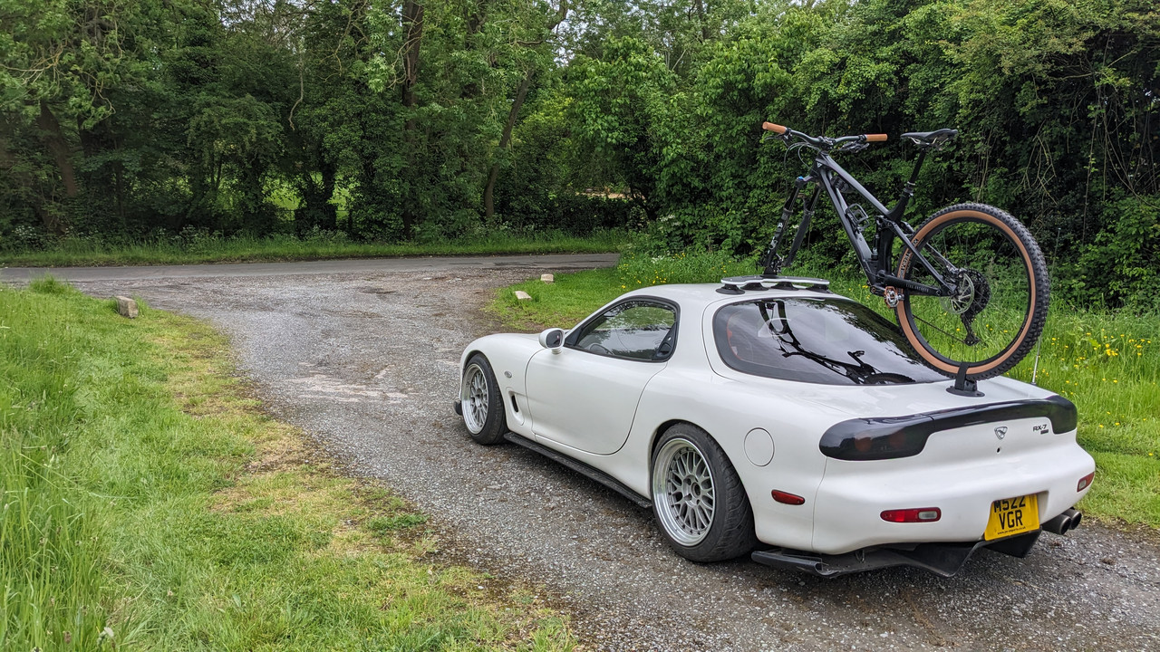

Posts: 66083
 496094553_10161712828977815_4599426443872744519_n.jpg I am thoroughly out-Mazda'd here! But here is a cheapo chinese one, it works great for me. The bike is too long for the car really so I can't use the rear wheel sucker, I bungee it to the rack instead. I went for a 2-bike one on the basis that it has more suckers, but I've never had any come loose (one of my 4 behaves differently to the others and I think it's probably weaker but it's never come loose)
Paint damage I think will be inevitable IF you fit it to a dirty car or have dirt on the suckers. So don't do that. MX5 paint is absolutely terrible but I've no marks after a bunch of uses and I don't expect to ever. My cars are always filthy so I just give it a quick wipe first. The easy thing will be to throw the rack in the boot without the covers on or get dirt in the covers or something and then just absently put it on the roof without cleaning.
If you're doing it alone it would be very easy to ding the bike off the roof though. Getting the fork into the rack can be bloody awkward. I throw a packing blanket up there to make it easier.
People often mention security but honestly I think this is probably effectively more secure than a classic Thule- those have no effective security, but give the false impression that they might via the locks, but also they're dead quick and easy to get a bike off and every thief knows how. In fact they'll probably do it faster than you can And then they can ride off but also, none of it really looks very suspicious if they're subtle about it.
Whereas these, are sort of a bit bewildering, undoing the fork is often slower than ripping a bike off a thule, removing the sucker board is fast but super awkward, and either way you have a nonfunctioning bike which looks odd to passers by.
