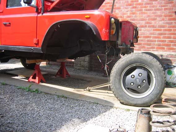

If you want to see something that looks dangerous (but wasn't) check out what I had to do to strip the underside of my fun car, looks lethal due to the central position. Was removing the rear subframe and all structural parts for a re-build and paint, and the sills are 0.9mm foil so I wasn't balancing it on them!
Fortunately a 28mm front anti roll bar coupled with a 6" gap between stands means I could climb in and out of it quite happily without it even shifting. I was VERY cautious at first! I wouldn't recommend doing the same at the front too 😀
Posted : 23/10/2012 8:03 pm

YEah if I was under a landy supported on stands I'd want them to be welded to the chassis and with a 3ft square base 😀
