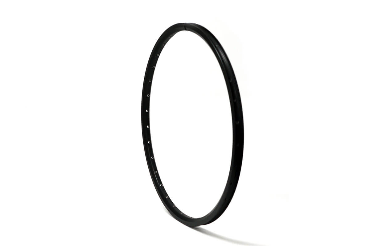

Condor Cycles do non-bombproof 24" rims, most likely just AlexRims but available in quantities smaller than "a container".

I see condor do rims:
32H at 460g each for £20.
im guessing I could get Deore hubs for £30 which with spokes and wheel building may get wheels for around £100, which is probably more in proportion with the value of the bike than the swish Superstar ones at nearer £300.
