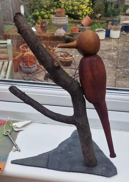

I have a woodpecker. I have a branch. I want to fix a woodpecker to the branch.
My first thought was just a wooden dowel into the body of the woodpecker and into the branch to connect the two, but I think that might look a bit strange.
I then thought maybe some coat hanger wire to make a pair of legs with claws holding onto the branch, but I'm not sure if that will actually hold it firmly.
My third thought was to ask you lot for any advice or suggestions.

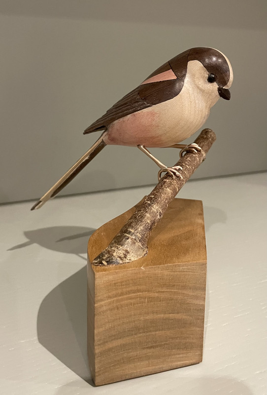

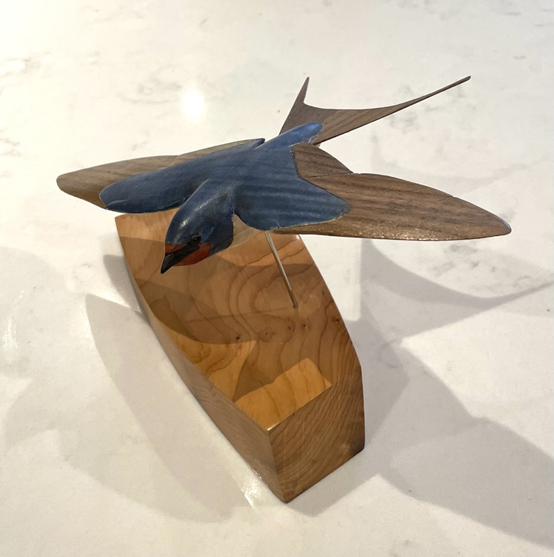

If I am fixing one of my bird carvings ‘in flight’ I use 1.5 mm diameter stainless rod. If making legs I use brass or bronze rod as it’s much easier to solder together than steel. I drill a hole in the base of the foot once made and use cyanoacrylate to hold a pin that goes into a hole in the wood.

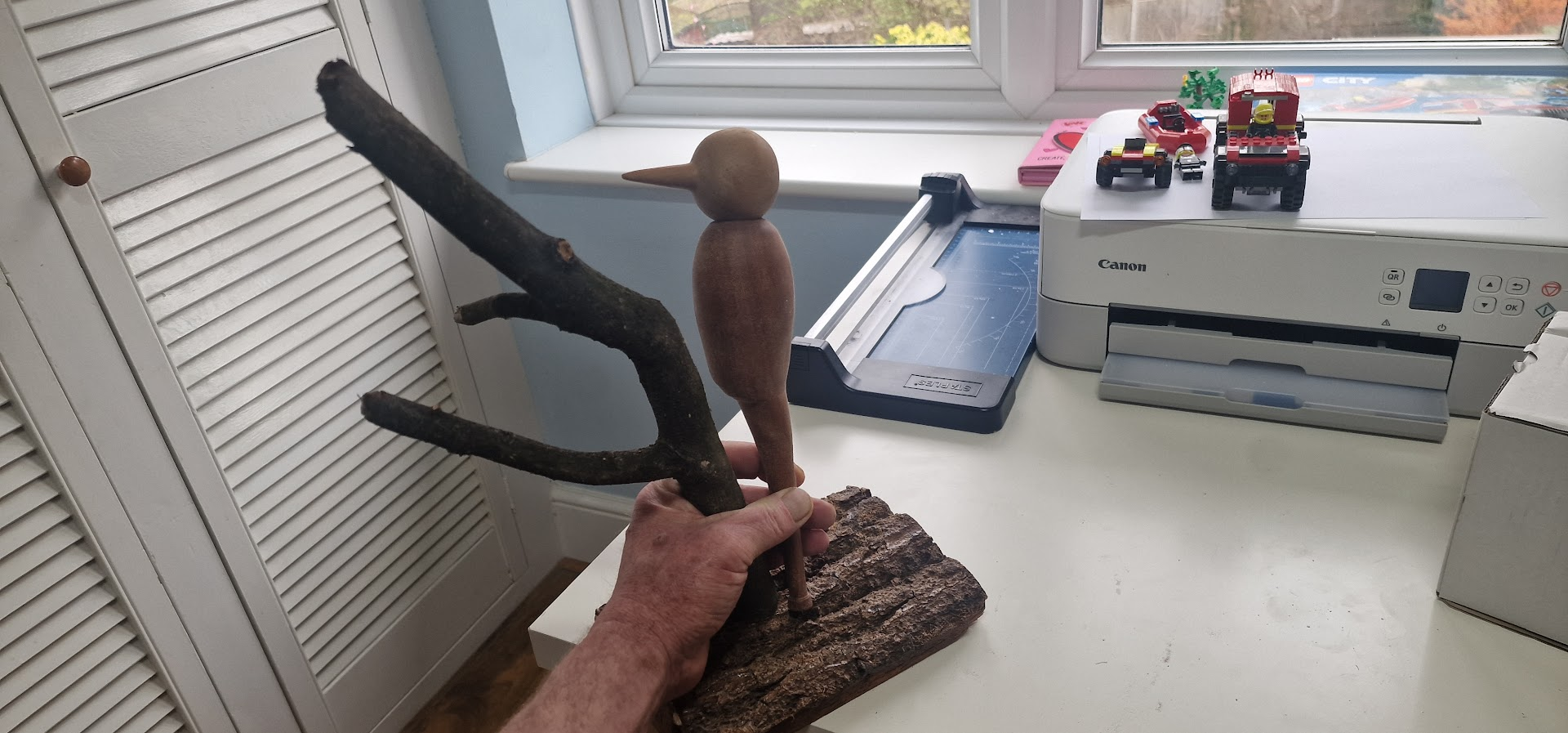

I used a short M6 bolt with the head cut off, two holes and some CA glue. I am now thinking I might put some black pinhead eyes on it as well as I have some left over from the hedgehog I made.
