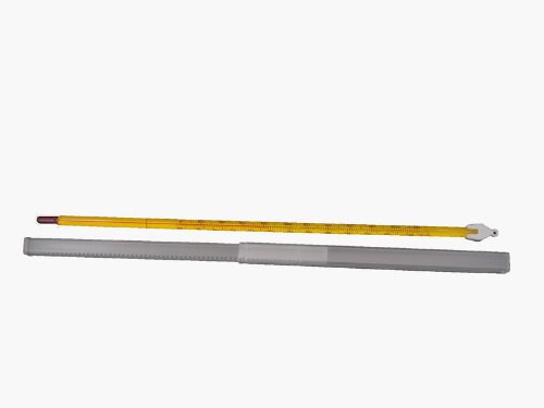

Posts: 8396
Completely wireless, and only £3.99 at Amazon

 IA
Posts: 563
Hard to log the data though 😉
