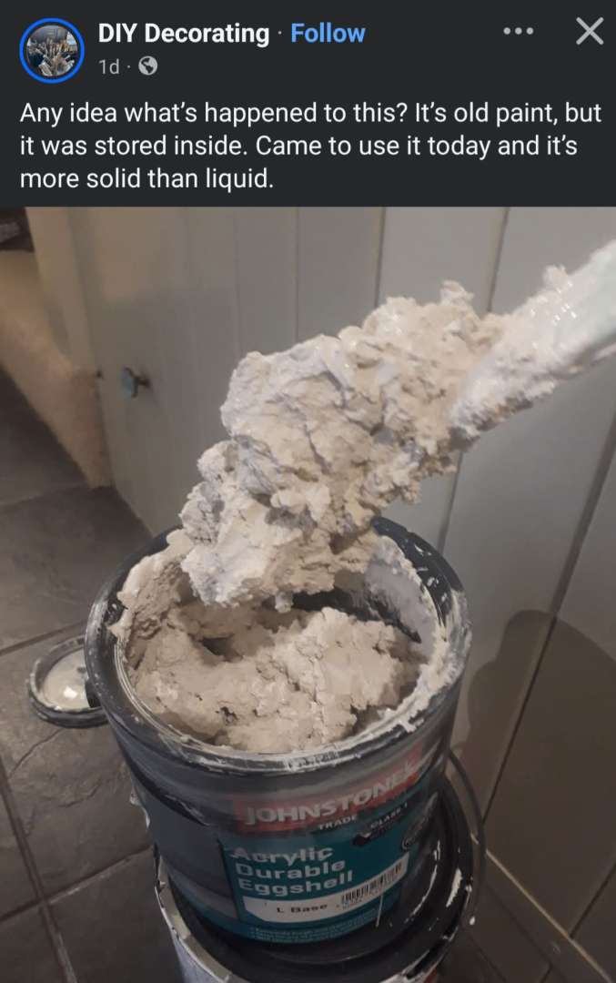

Posted : 27/01/2026 8:21 pm

Posts: 1026
Posted by: bruneep
Could be worse
Yep, that’s Jonno’s acrylic eggshell for you
