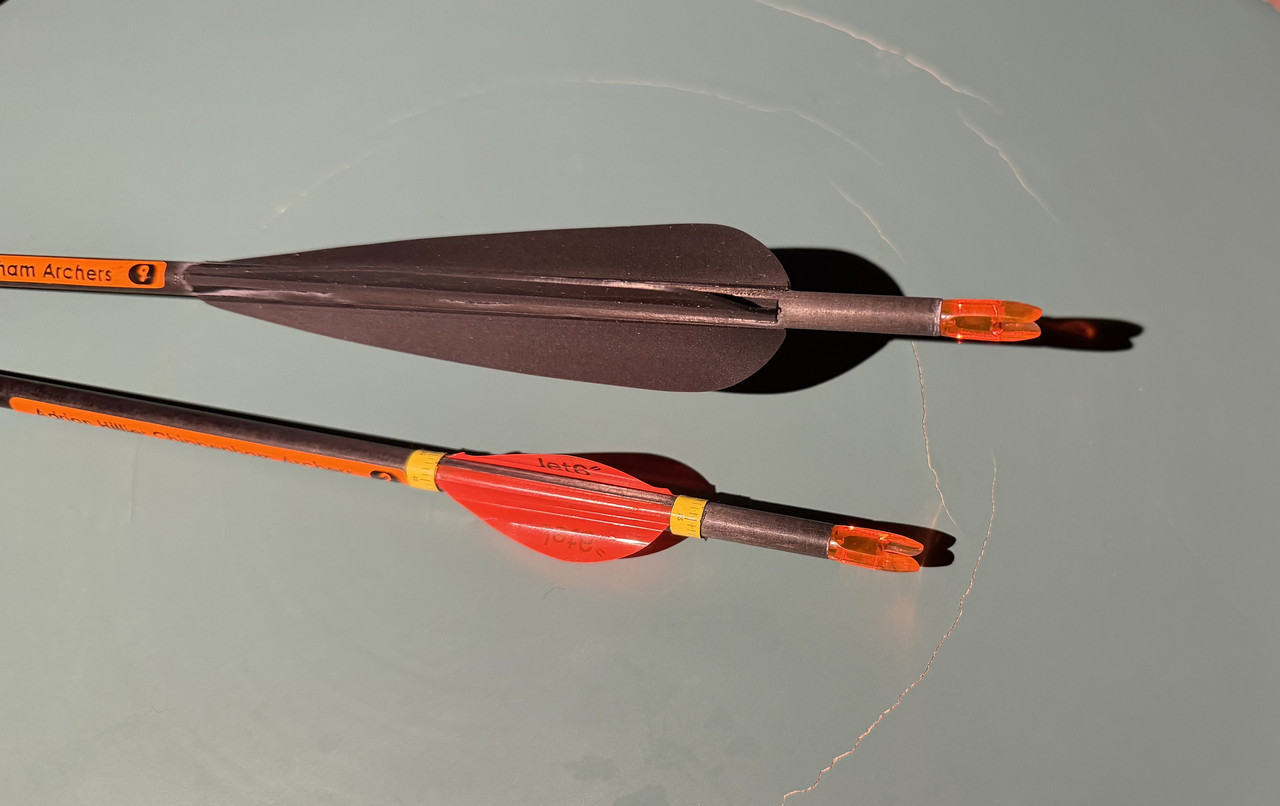

The last thing of any significance, ie more than a dab of glue, is the grip on my bow. The original one cracked down the lamination, I fixed it but it cracked elsewhere, turned out the two screw holes were mis-aligned causing it to be over-stressed. I got a replacement, but I’ve been wondering if I could customise it to better fit my hand, because my arthritis in my thumb joints can make it quite uncomfortable after a while - the top of the joint can rub raw, which is painful.
So, I bought a little rechargeable rotary tool, and used the cylindrical grindstone to reshape the screw holes, then scored the top and rebuild it with black Miliput, adding a little bump lower down the handle, then wearing a nitrile glove pressed the grip against my hand in the position it rests against my hand. It’s important to point out that you don’t actually grip an Olympic recurve bow, it sits in the ‘V’ of your thumb and forefinger as you hold it out, with a chord or strap around the back of the hand, it’s drawing the bow that holds it in place, once you release, if there wasn’t a restraining strap it would fall on the floor.
After shaping a bit of dense foam and sticking it where the top of my thumb fits, it now happily sits in place with no effort.
Really pleased with how it’s turned out.
The new grip alongside the customised one on the bow.
In place, sitting in exactly the right position, with no effort, the strap is the woven paracord hanging down below, it would normally loop up over the back of my hand.
I’ll probably wear the elastic wrist support now, which I couldn’t before, it gets a bit uncomfortable after shooting for two hours or so without it.
My last end last night, using the new grip, and a bit of coaching to correct som bad habits I’d got into…

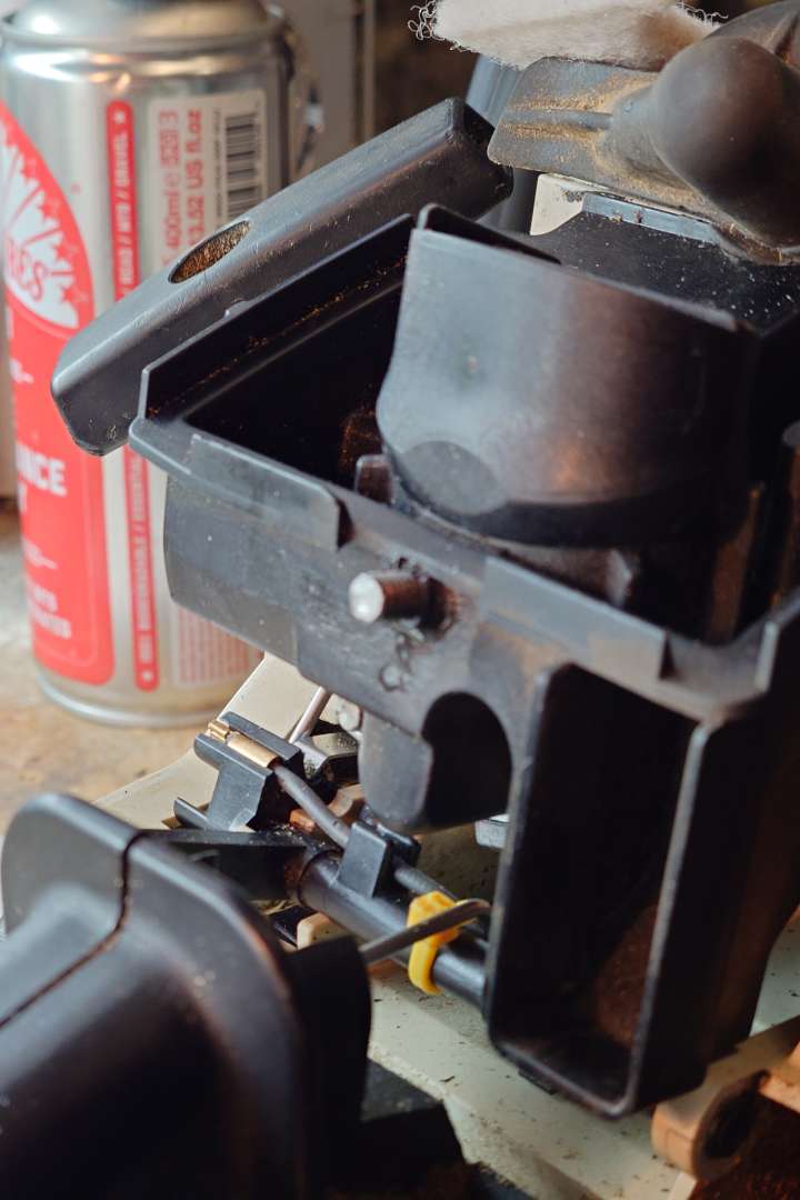

Repaired the hose attachment on my SKS rennkompressor. Threads had gone so drilled out, tapped and fitted a m10x1.5 to 6mm barb. Also finally fitted the larger dial and lower pressure gauge I bought ages ago.

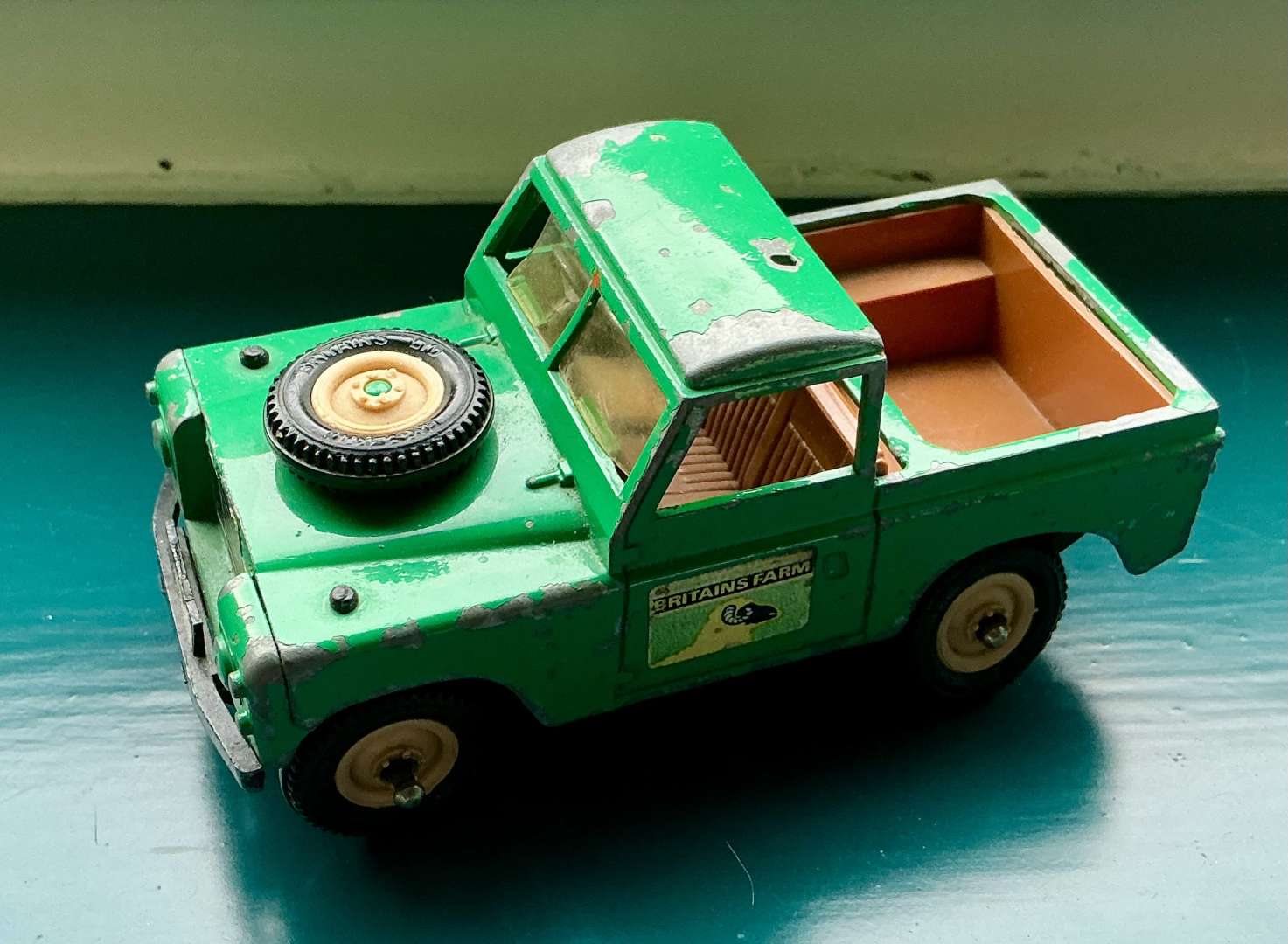

A very old toy donated to us, all the plastic holding the front axle in place had broken and disappeared. I used a small piece of Ikea chopping board with a groove to hold the axle and a self tapper to hold it in.
Ikea chopping boards are a resource that no workshop should be without, easy to saw, slightly flexible and also takes a screw. I’ve used them for kitchen drawer sliders, door catches and stopping adjustable tow bar rattles - amongst others!

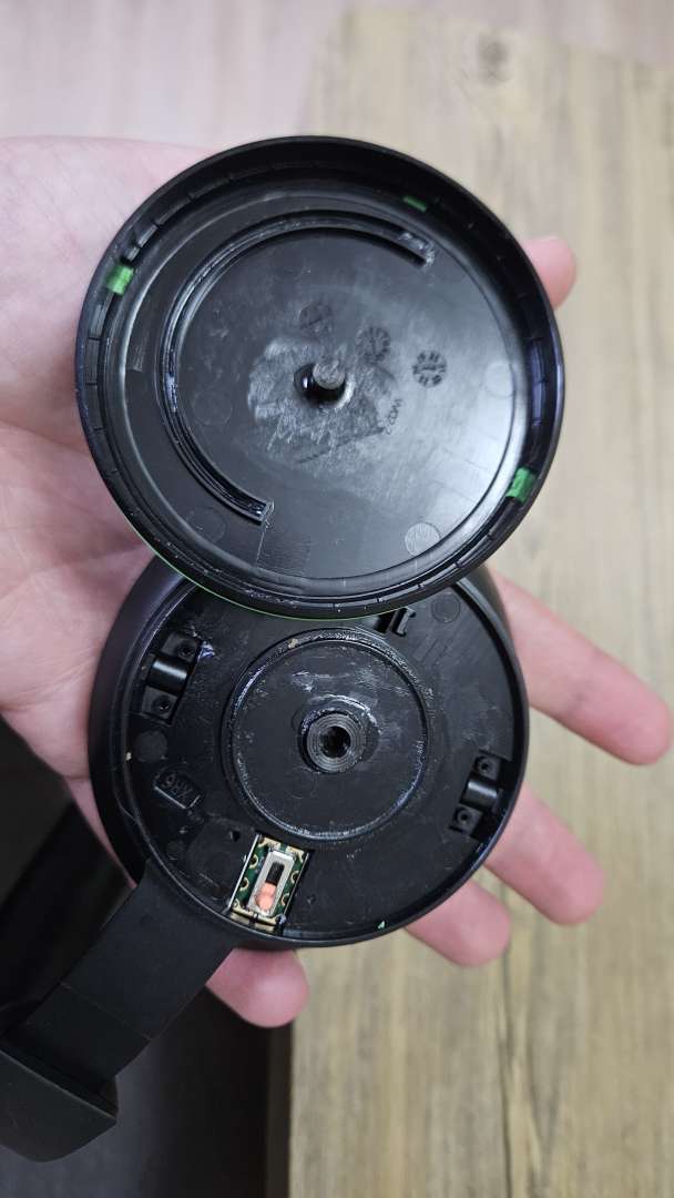

Posts: 1127
Just fixed a broken volume dial which my daughter snapped of a set Xbox wireless headphones.
Big thanks to @stumpy01 for the 3D printed parts 🤗
Photos are in the reverse order but I'm posting with my phone.

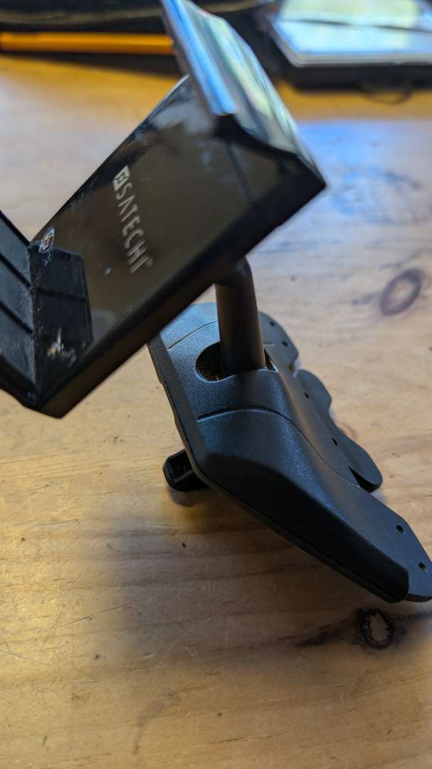

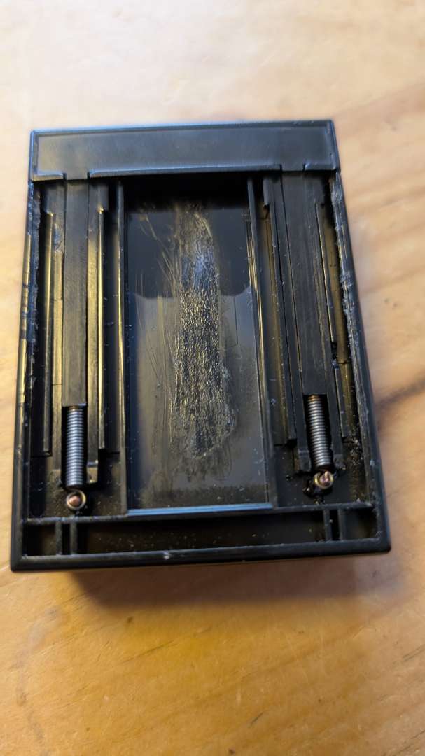

MrsP has a phone holder in her car that has a sprung sliding clamp. Except it stopped being sprung so wasn't much use for holding phones. I prised apart the mechanism and found that the two plastic lugs that fix the end of the springs had broken off, so drilled a couple of small holes and glued in some small lengths of copper wire. Reassembled and it's a functioning phone holder again.
PXL 20251028 100046822
PXL 20251028 100159307
Posted : 28/10/2025 10:24 am

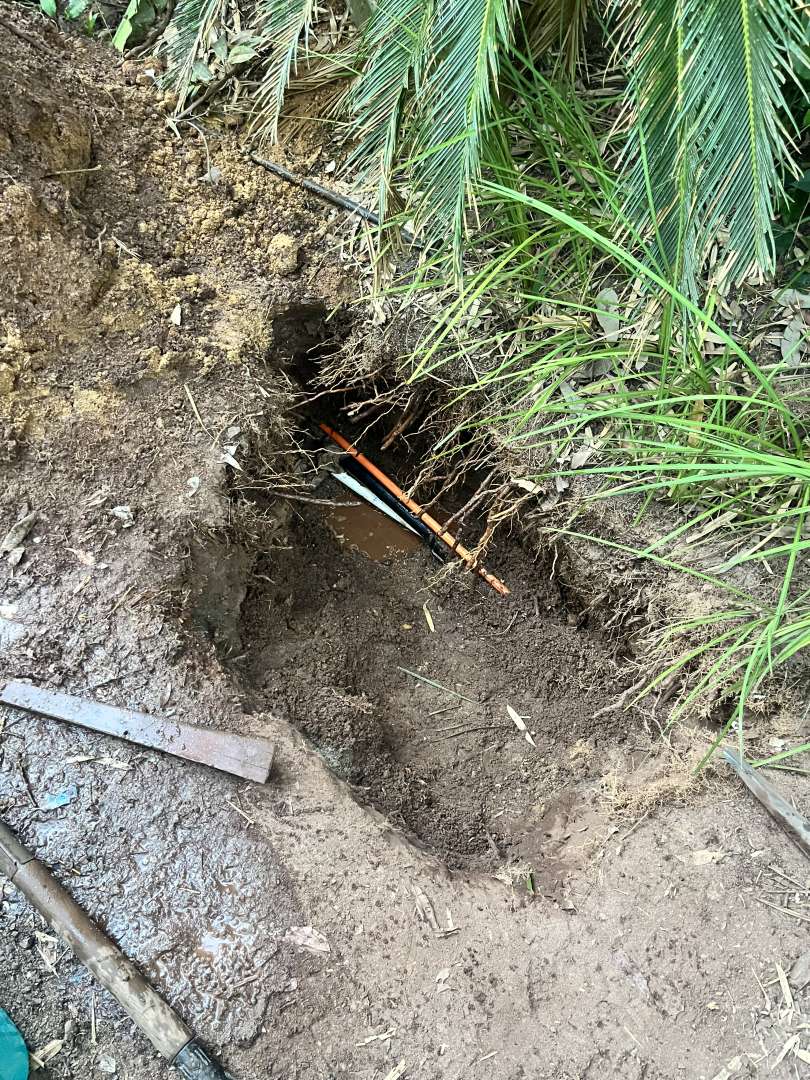

Had to sort out a leaky pipe under the sink recently. It turned into a bigger job than I thought 🤪 ended up replacing a section and re-sealing all the joints. Bit stressful at first, but pretty satisfying once the drip finally stopped.

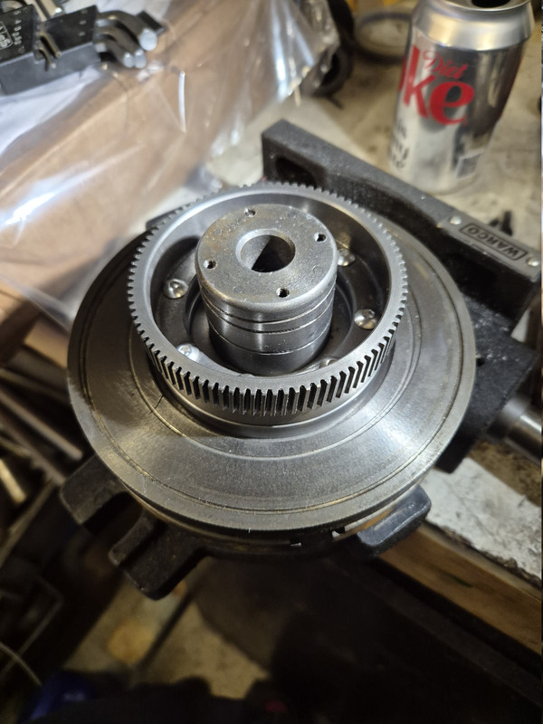

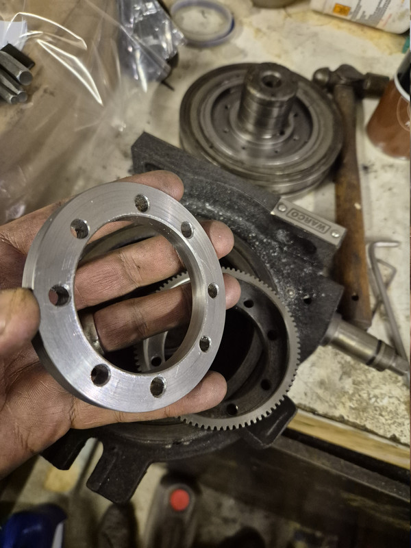

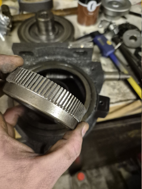

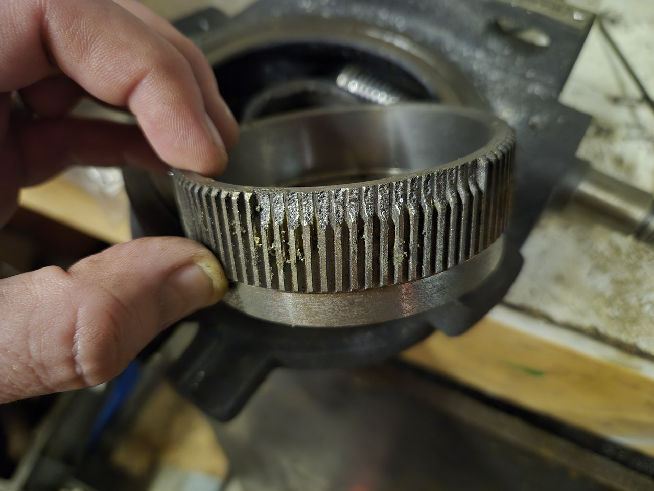

Posts: 1082
I was lightening a flywheel and in a moment of utter stupidity turned the wrong handwheel on the milling machine and crashed the tool into the work piece.  Result: stripped a load of teeth off the gear on my rotary table.
These cost a fair bit so repair was worth a try
I turned down the damaged section of the gear
Made an 8.75mm spacer to drop the gear down onto the undamaged teeth. The hole pattern was not regular spacing which was a PITA.
Fitted back on to the bottom of the table.
Now it's all back together and working perfectly.

Not quite a repair, so much as an upgrade. When I had my carbon arrows made up, I opted for SpinVanes for the fletchings, which are a fairly complex type of setup, in that they’re taped in place, with tape wrapped around an extension at each end. Trouble is, they have a crease along the bottom edge, and I’ve had one tear off, and found a couple more with splits, so I’ve bought a fletching jig, and a packet of conventional vanes, and tried my first attempt at fletching my own arrows.
I won’t have chance to try it until next weekend, our club range is sodden at the moment, and shooting in the rain isn’t much fun, but it’s looking good so far.
Easy to tell the vanes apart, the SpinVanes are dayglo orange.
Just to add, to avoid confusion, arrow fletchings traditionaly were feathers, so were called flights, but with synthetic ones, while you still fletch arrows, they’re more commonly called vanes now, and sold as such.
When a sport has a history going back several thousand years, materials change and so do names, which brings in elements of confusion; points were usually called piles, but it’s easier to call them points. 🤷🏼‍♂️

Posts: 7467
Water bill showed we used over double our normal usage in the last quarter…
Our house is 350m from the meter so I called out the leak detector. He took all of 10 minutes to find the leak.
The previous owners who laid the pipe used an inferior product with a thinner wall that is prone to cracking.
So that left it to me to dig up the pipe. It’s a bit awkward because the phone and power lines are collocated. Easy enough to dig without damaging anything, easy enough to cut the pipe. But an anger fest trying to fit the joiners and get them done up tight.
Dug it up on Friday. Fixed and backfilled on Saturday.
Posted : 08/02/2026 11:59 pm

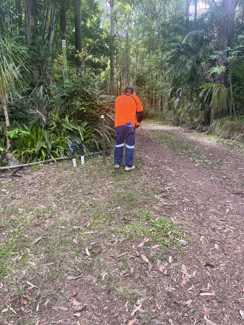

Posts: 470
Reeksy, good work, I work with water and leaks! what method was used to find your leak and it is main or private pressure? Thanks C.
Posted : 09/02/2026 9:16 am

Posts: 7467
This guy uses a stethoscope thing with a box that beeps (that’s my technical description!). We fitted a valve the first leak we found (maybe 10 years ago) so that he can pressurise the line and then presumably listen for the noise. He said he has about 60m range before another valve is needed. But on this one he said he’d try without and it turned out within 5m of the valve!
We’re on mains. Virtually the last house on it I think.
Neighbour called tonight to say there’s a leak on the other side of the meter so I guess I’ll check that in the morning. At least that shouldn’t be our responsibility.

Posts: 78218
Posted by: CountZero
I don't think I've ever owned arrows I haven't made myself.  Fletching isn't particularly difficult.
I dug out my old kit the other day.  Time has not been kind to my arrow staves, I think if I threw them out they'd come back.

Posts: 33873
@Cougar - when you’re starting from scratch, it’s enough getting all the rest of the equipment together, trying to fathom how to make up a set of a dozen arrows for a recurve bow before even being able to use it is too big an ask. These arrows are carbon shafts, a second set, and the SpinVanes I wanted are far too complicated for a beginner to try fitting, which is why I’m now replacing them with standard vanes I can easily set up with a jig.
Using SpinVanes was, in hindsight, really not such a good idea, and didn’t bring any significant benefit, running before I could walk, basically.
It is, as you say, quite a satisfying thing to do, especially when the weather’s as crap as it is!
I’ll set my bow up later, just to make sure everything is aligned correctly when nocked, then start working on the other ten - there should be a dozen, but one went under the grass while setting up sight marks, and the mower went over it before I could find it, and nicked the shaft in several places, it broke into pieces when I tried flexing it… 😖
£10.50 for a replacement bare shaft…
