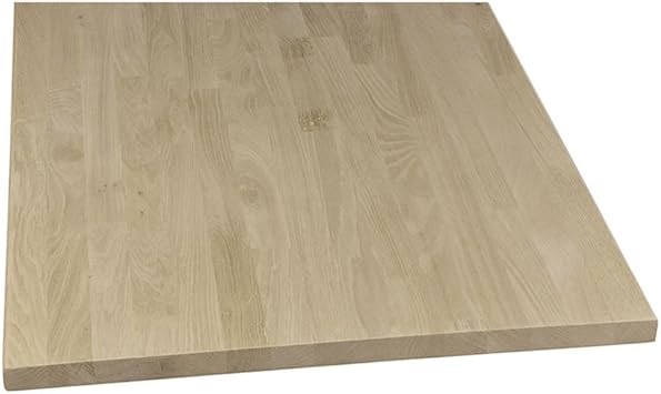

I've done this in a couple of houses using Oak Furniture Board. Given it's glued fingers of oak it's cheaper than solid wood, and you'll never notice the difference.
Oak
The best place to source it from will depend on your dimensions I suspect.
As an alternative to batons, I've used aluminium right angled bar. Simple to drill through, and by sitting the wood into the 90 degree angle, it's cleaner than wooden batons.

Had discounted furniture board, as they tend to look expensive. But once cut to correct width they don't look too far off the money. Good stuff.
Really like the angle iron idea, might go down that route.
