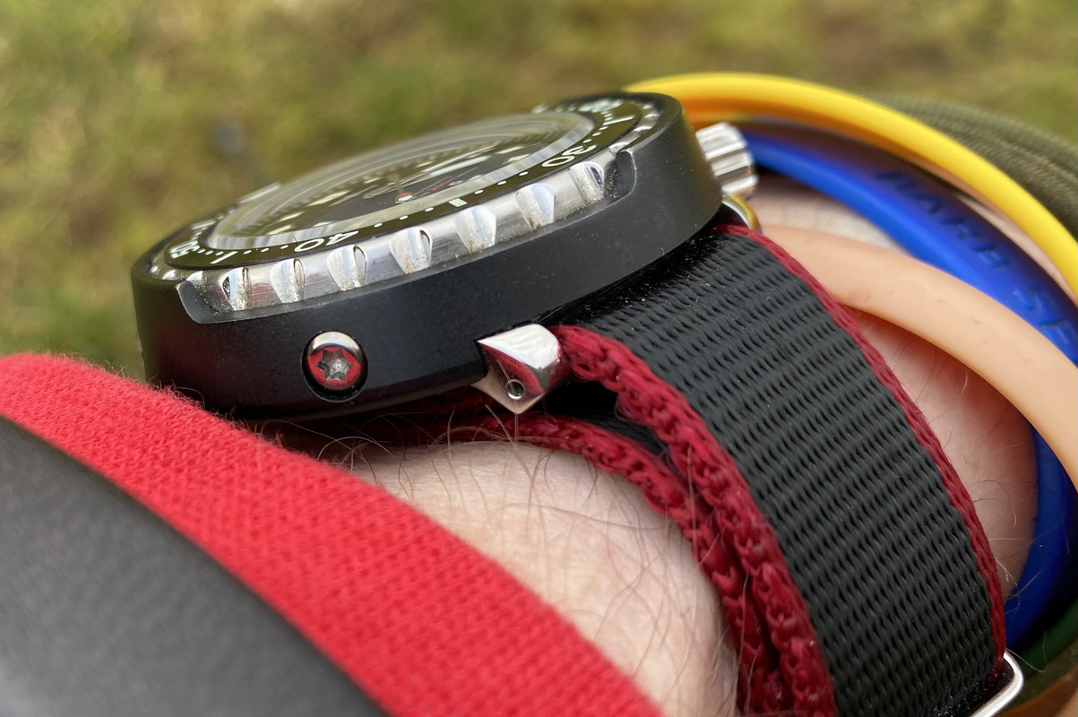

Posts: 33524
the ones with just a stick can be difficult, really sensitive to the tiniest movement.
Like the adjuster on Seiko movements? I can attest to their sensitivity, when I wanted to regulate my SPORK! Took several goes, the final adjustment was an almost unmeasurable nudge, which took it from losing a minute a week, to gaining a minute a month, which I felt was acceptable.
The new movement which I had fitted to my Heimdallr Tuna, and which I set when I got it back on the 9 of January is currently exactly 1’30” slow, which isn’t bad for a cheap Seiko movement!
I’m certainly not going to fiddle with it, too little margin for a large error.
I took a couple more photos in daylight yesterday, to show the little Torx screws I had made, and a better pic with the new face, hands and lumed ceramic bezel.
Posted : 22/02/2021 10:47 pm

Posts: 727
Had some money to spend as a retirement gift from work so just bought one of these. Fancied something with a bit of colour as all my watches have black faces. Really pleased with the weighty feel and look, makes a nice change to have some colour! The brushed finish to the stainless steel is almost titanium in appearance which again is a nice contrast to my other steel bracelet watches.
[url= https://i.postimg.cc/gx0bkbxm/boldr-Odssey-freediver.jp g" target="_blank">https://i.postimg.cc/gx0bkbxm/boldr-Odssey-freediver.jp g"/> [/img][/url]
Posted : 03/03/2021 10:35 pm
