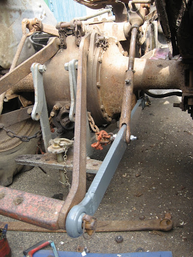

The lift arm balls on my TE20 have worn to the point where they popped off their mounting pins. Without properly checking what was involved in their replacement I ordered the parts. Turns out the lower mounting pins are bolted from inside the rear axle 'trumpet'.
So it looks like I will need to separate them from the rear end which looks like a much bigger job. It's further complicated as my tractor has a MIL loader which is mounted to the rear axle too.
Has anyone else undertaken this, is there anything I should look out for, special tools required etc?

mcM is this what you've bought?
If so and the lower link is slipping off i don't really understand why you're replacing the mounting pin when it's the ball in the link that's worn.
Shouldn't you just be replacing the ball?
Posted : 03/07/2013 11:55 am
Posts: 91
Sharkbait. That's the part I have. Both the pin and the ball are really badly worn. As a temporary fix I might make a big washer to hold it together, but the pedant in me knows that is not the long term solution. I'm actually looking forward to the challenge of fixing it.
To be honest I bet that would last a very long time!
As I see it that pin should have a sacrificial "bearing tube" over it to take the wear and give a good fit on the lower link ball - do you not have those fitted?
My project looked scary but wasn't actually that big a deal!
You'll be fine, put plenty of support under the gearbox and hope the nuts come undone easily enough. 🙂
Posted : 03/07/2013 1:25 pm
Posts: 91
It's too late for that now. Both the ball and pin are worn in an oval.
The loader uses hydraulic pressure diverted from the lift arms, so it is always generating wear.

I found some time this afternoon to get the new lift arms fitted. There wasn't enough wear at the pin to justify splitting the rear of the tractor, the wear was concentrated on the balls and the arms.
The hardest part was drifting out the bushes on the draft control links. Lots of blow lamping and hammering got the out.
So now its fixed I don't need to worry about the spitter falling off as I trundle around.
Job satisfaction rating? Pretty high. 🙂
