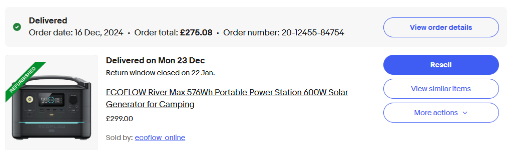

So I bought a factory refurb ecoflow River max which was comparatively buttons. Its proved very, very useful. Its only a little 576wh If I go away for a weekend I can do a full overnight charge of my Levo SL and its range extender, plus a bit of lighting and phone charging. We also use it loads in the garden in Summer, its lives in the van, it can also power my boiler at home in case of a power cut, etc etc.  Itll do 1800w on mains too, useful for power tools. Can charge from mains at home or shore power, 12v from the car, or Solar up to 600w.

Not expensive either, look at all the big brands factory refurbs...! You'll need something bigger for full fat ebikes but its still going to be way cheaper than doing a leisure battery install in a van, that is far less versatile.
