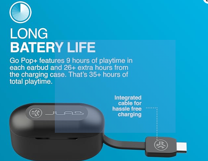

Wife bought a pair of J Lab earbuds, they need a USB-C wall  charger that provides" 5V with up to 1A ( 5 Watts)" apparently.Ive disappeared down a rabbit hole trying to find something that charges safely ( I thought bike standards were annoying)
Apparently she needs an intelligent charger that will only charge to the required amount? I can find loads of 20W ones , that was what Argos said she needed 🙄
If it is an " intelligent" or " adaptive " she needs U Green ?it's going to cost more than the earbuds 🤬
I wish she'd been a bit more careful opening the box could have sent them back 🙄

@Cletus you actually charge the case , there's a lead that comes out to plug in to a wall charger
Posted : 20/02/2026 5:01 pm

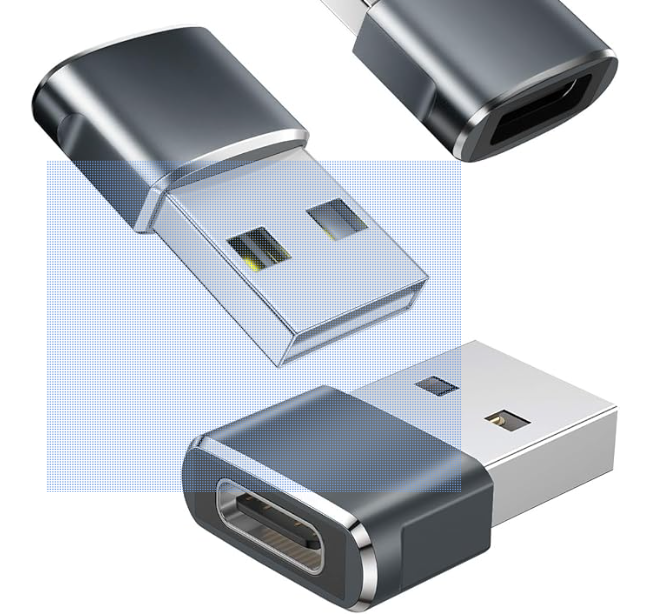

I see the problem.
It might be worth getting a Type C Female to A Male Charger Cable Converter to allow you to use an old low power charger.
You can get a 3 pack for £3.99 on Amazon.

Mrs Kayak23 has the J-Lab Go Air Pop ones.
To be honest I don't think we even gave the charging a second thought. Plug them into any of our usb plugs without issue.
Posted : 21/02/2026 7:26 am
Posts: 4845
@Kayak23 I would have been the same but we didn't have a USB-C charger plug that's when the rabbit hole opened up 🙄
Posted : 21/02/2026 8:55 am

Did it come with a USB-C ↔ USB-C cable and no adapter?  That's unusual.
You don't need to use the supplied cable anyway, a plain old USB-A ↔ USB-C cable charger would be fine.  How do you charge your phone currently?  (No pun intended)

Well I paid a fiver for a pair ( I only needed one 🙄) of U Green A to C adaptors and they worked fine 👍
Wish I knew that before being bamboozled by incorrect/ misleading/ unhelpful " You can't do that " " That won't work" advice , not from here I might add 👍
