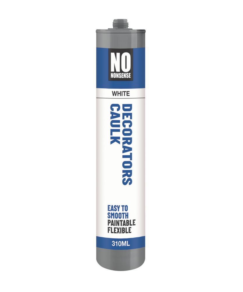

I mainly use this as it's 99p a tube at Screwfix
[img] http://s7g3.scene7.com/is/image//ae235?src=ae235/57568_P&$prodImageMedium$ [/img]
It does shrink a bit and isn't the best I've used, but it's so cheap, I just use several coatings.
http://www.screwfix.com/p/no-nonsense-decorators-caulk-white-310ml/57568
