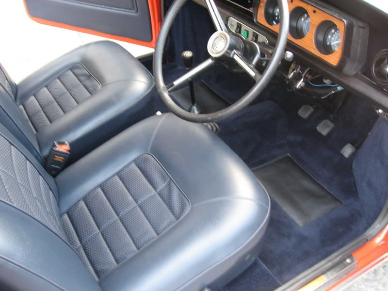

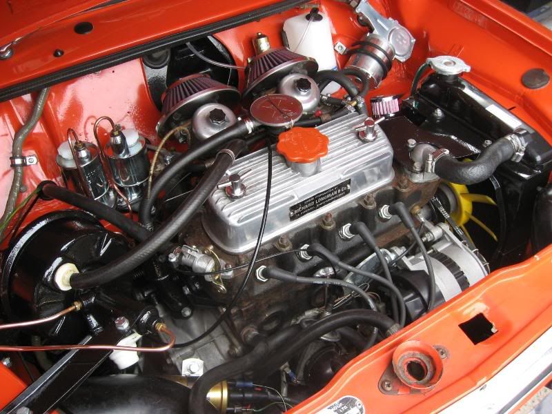

sold it on classic car trader site cant remember name now (took a while though)
it was re-shelled in the early 90's with a nos shell (zero rot - it was very solid car)
I'm not mechanically minded but did quite a few jobs on it. get a good book and some decent tool (plus big hammer) its nuts & bolts stuff really.
dont fall for all the 'trim' get a 1ltr city if the body & sub frame is good. trim/wheels etc are cheap - restoring body work is expensive or looks shit if ya do it yourself.
look here http://www.carandclassic.co.uk/list/82/1000/
