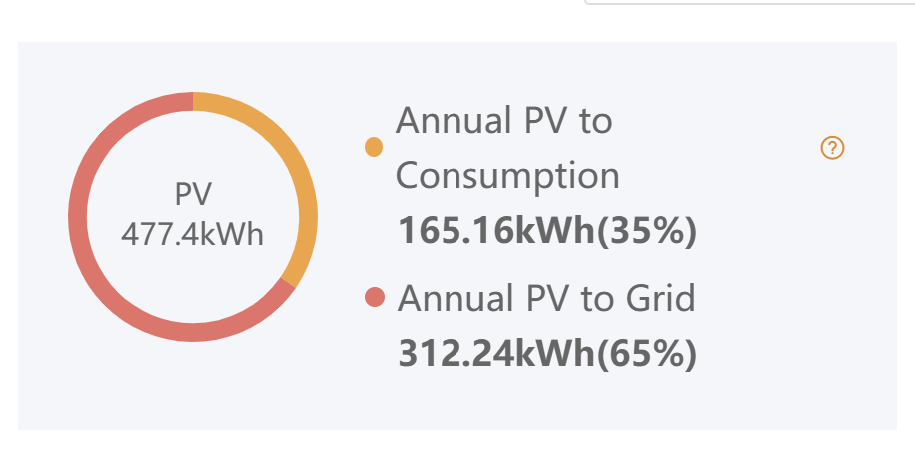

It transpires my house has MCS certificate, despite being told before it does not.
I have 6x Viridian panels and Growatt inverter with estimated 1540kWh generation annually.
Currently on Octopus Intelligent Go, EV X 12k miles, a person at home all day, 4 bed/4 people house.
Getting better at using cheap overnight AND load spreading through the day to maximise any solar. We do plan to use as much as we can locally rather than export.
Is there any downside to signing up to Outgoing Octopus (flat rate) on top of Intelligent Go (which is how I understand it works...) and selling on the odd occasion we have some "spare" electricity?

That the 12p rate? If so thats what I'm on, so no downside. You're coming into right time of year now to export as much solar as you can, this is where batteries can help to store excess to use at at night and poor solar days but that's another topic.

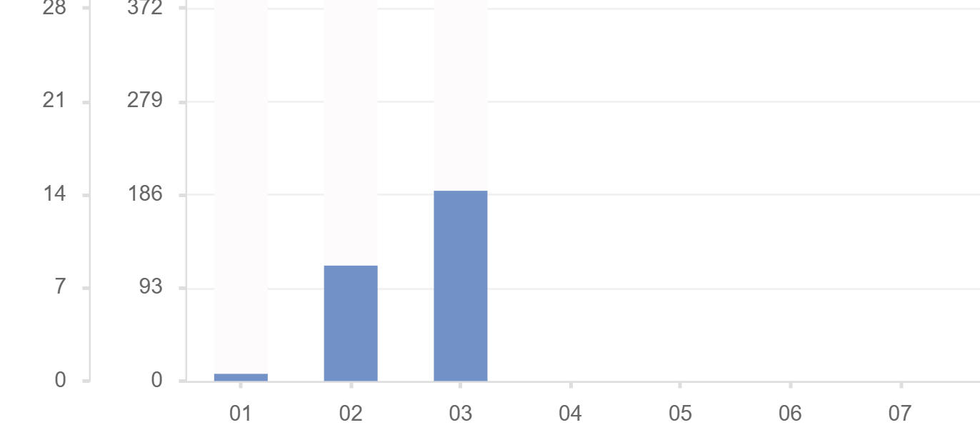

so far this year I've generated this
January was piss poor, but its getting better now
Posted : 17/03/2026 6:13 pm

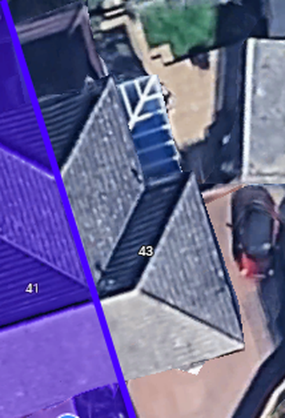

I've been considering getting panels for a while.  Assuming Google Maps has North oriented correctly, is my roof (#43) a good angle to make them worthwhile?
The east facing ones are in bright sunlight all morning, but less-so in the afternoon, the south facing one has less capacity, but I assume gets sun for more of the day.
Posted : 26/03/2026 12:25 pm

I should elaborate a little...
I used this online calculator and it suggests a payback time of 19 years for NE facing roof, and 16 years for Easterly!  Seems excessive - I just wondered if real world experience might be different to an online calculator.

the east will get first thing in morning and as the sun climbs, but you'll potentially get shading on the most northerly section of roof mid morning? so you may need a triple array to make it work? or panel optimizer doo dahs
South will work till mid / late noon?
im thinking how mine works, your south roof is a very similar angle to mine
The big savings would be with a battery and time of use tariff
