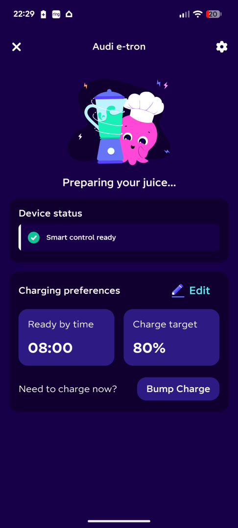

Anyone know any answers or have experience of VW/Skoda on either Hypervolt or Ohme via IOG?
I have an early Audi with OIG and a Hypervolt. 3. I can use the Audi app for setting charging limits and cabin heating etc and the IOG controls the charging schedule. Not sure if that helps. I can use the Hypervolt app for monitoring charge rate / locking the charger and changing the lighting colours.

@binman I think that if the app is linked to the API from the car manufacturer it will report state of charge and things like that in the Ohme app. Presumably the car's own app will also show that sort of thing and whether or not it is actually charging etc. Does yours do that?
My car app shows whether it is charging/ rate etc, but I chose to link Octopus IOG to the Hypervolt, so only the Audi app will show state of charge. It has worked well so while i have been tempted to try linking the car, it's not broken, so not tempted to fix it.

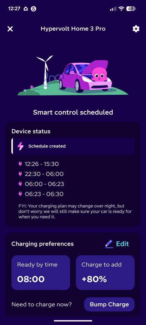

I have IOG set to charge at 100% all the time and  to be ready at departure time 0700 then I use the Kia app to set the charge limit for car be that 80-90-100%
Any idea if the Hypervolt will actually link to the Audi API or not though?

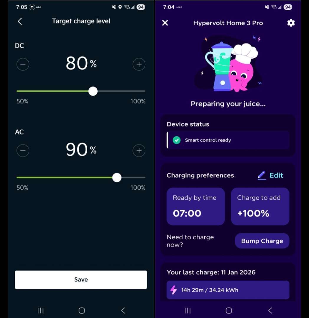

Ok, just tried removing the Hypervolt and connecting to the car, it seems to have connected to the car using my Audi login but with no option to use the Hypervolt anymore. Can't see the state of charge of the car in the Octopus app, which is disappointing. Will see if it works tomorrow evening as the battery is at 80%.

@binman - I think that during the setup process in the Octopus app you now don't have a choice to setup either a charger or a car. You put in the details of both and if the car is API compatible with IOG then it will connect to the car and as long as the charger is IOG compatible IOG will control the charger output.
So in the case of Ohme what you then have to do if IOG has linked to the car API is to fill in the form to get Octopuss to switch it over so the charger is linked.
For Hypervolt you either need the car to be compatible or use the settings in the car to do things like limit the max charge and then leave IOG putting 100% in always.
What you see to have to do if there is no API integration is tell it how much charge you want to add rather than the charge limit. So if the car is at 50% and you want it to be 80% you have to tell IOG to add 30%.
I would be interested to know if once you have added an API compatible car in the Octopus app whether or not it allows you to say "charge to 80% each time it's plugged in" instead of having to keep changing the percentage needed depending on how much charge is already in
Presumably if you have a Hypervolt and a car that doesn't have API integration you would say to IOG add 100% and set a charge limit in the car itself of 80%. This runs the risk of it not working out when to charge though I would imagine as it will think it needs to add 100% in 6 hours rather than say 40% (because you plugged it in at 40% and you want 80%).
Now you have added the car can you tell Octopus to charge to 80% or do you have to tell it how much to add?

I think it has changed as it used to ask how much to add.
Posted : 11/01/2026 11:31 pm
Posts: 3488
@binman Yep - that looks correct. Octopus has linked with your car's API. Thanks for testing and posting that. It would seem that the car I am after (PHEV) is not supported by IOG but potentially it is supported by Ohme in which case if I want a fit and forget "charge to 80%" profile then I will need an Ohme charger and will need to use their app to manage this. The Ohme chatbot says the Volkswagen API is available but I'd like confirmation from Ohme as Octopus also support VWs, just not any PHEVs by the looks of it. Ohme could be similar....
I find this way easier as you don't have to work out % on the Ollie app. This was how I was told to do it by Octopus.

Posts: 1089
 Screenshot_20260104-122745.png That's what it used to look like, but it won't let me revert to this setting.

Posts: 3488
Posted by: bruneep
On his screenshot he has the car (Audi in his screenshot) controlling the charger rather than the charger (hypervolt in my screenshot) controlling the charge
I beg to differ, he connected OIG to his car API rather than the charger and then OIG is able to query the SOC. in this way you can tell it to charge to x% rather than add x%. OIG then controls the charger telling it when to stop. Except it didn’t work.
Posted : 13/01/2026 9:06 pm
binman reacted
Posts: 3488
As per @bruneep post OIG will try and query the car (well the API in reality ) for an accurate SOC as a preference as it can the forecast how many kWh you will need accurately and thus budget network load accordingly. When IOG relies on the user to tell it how much charge to put in this is invariably not going to be as accurate. As @bruneep says - try adding a car that is not compatible.
Posted : 13/01/2026 9:12 pm
binman reacted

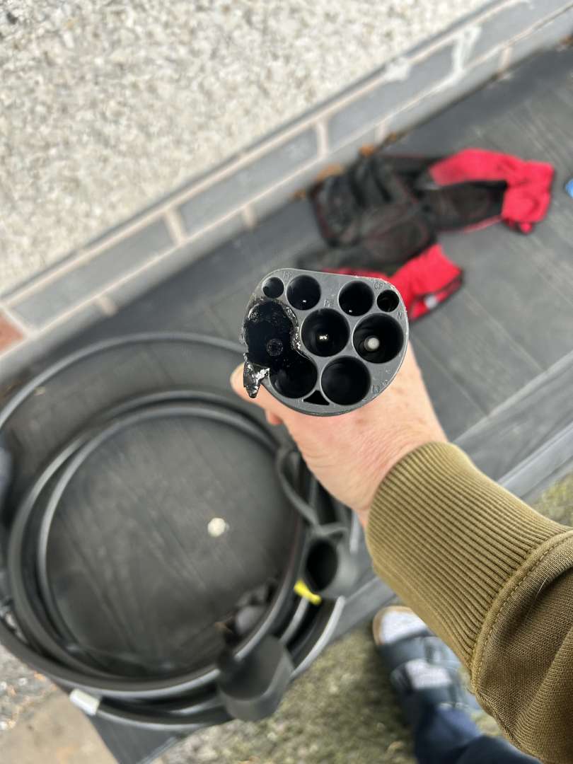

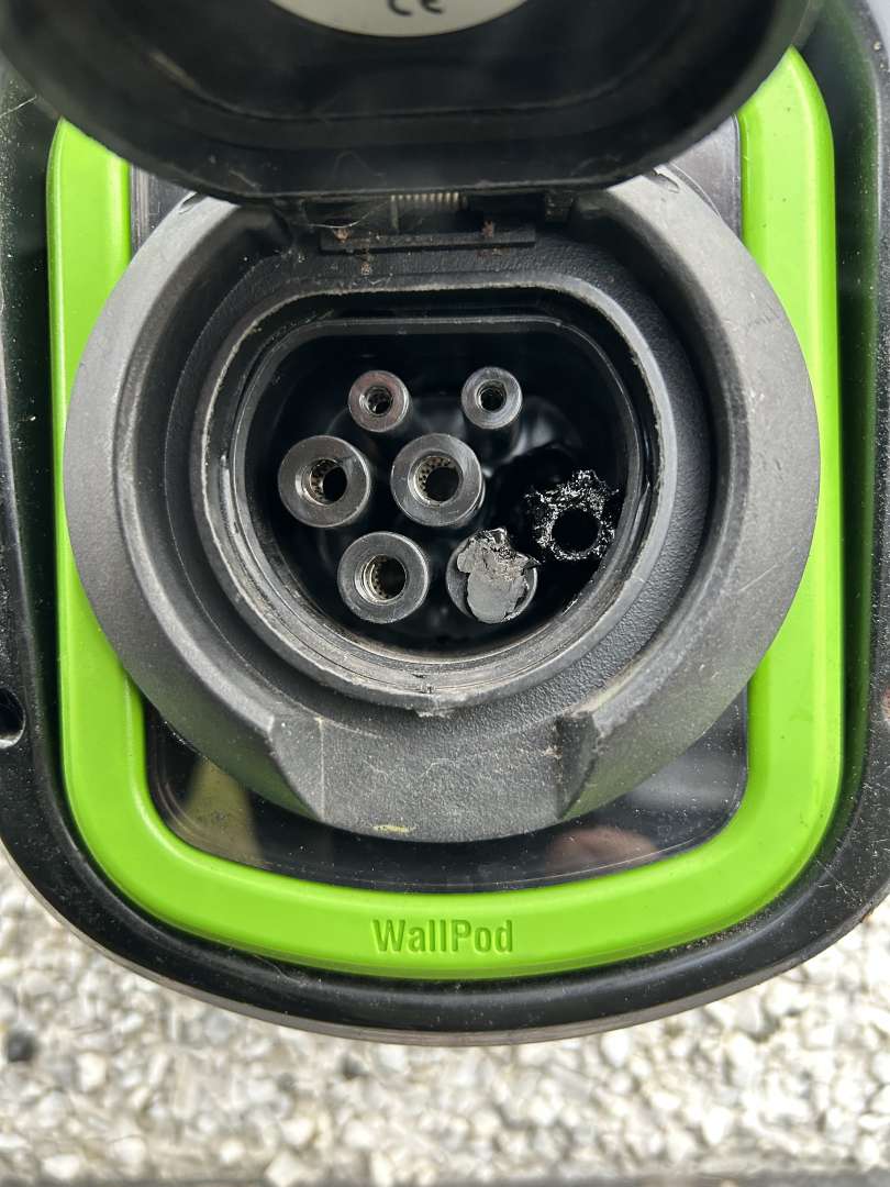

Posts: 5136
Oops! To be fair it is 7 years old and it had developed a habit of not releasing the cable after a charge, which I should have investigated sooner.
