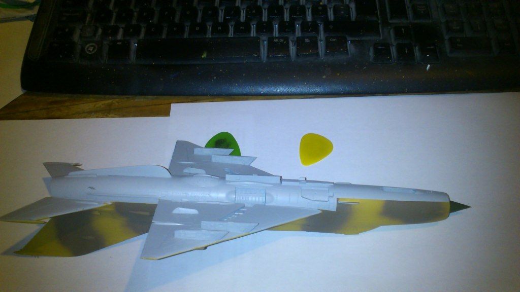

I just bought this [img] [/img] and after giving it a base coat of black spray paint I just cannot seem to get the colour correct. Which paint is best?

Why did you give it a base coat of black? General rule is go lighter to darker, painting on black will always 'tint' the colours on top.
Posted : 06/01/2013 6:57 pm
It's the only spray I had in lol.

It even had the paint with it...
Follow the paint chart, use decent paint and practice - like most things in life.

Traditionally, undercoat has always been neutral grey, or occasionally, white. Never black, especially when the base plastic is grey...

harrier GR3 in green & grey. IIRC the undersurfaces were a paler shade of grey than the upper surfaces.
if you're spraying, you'll need bigger pots of paint than those little thimbles.
Don't add the undercarriage, it's a bugger to mask. same goes for brittle bits, leave them until after. If a modern military aircraft, the underwing pylons often get in the way of the decals, so if that's the case, leave those off for now as well.
mask off the cockpit canopy with Maskol & spray the whole thing with the palest shade of grey. Then mask off the demarcation between upper and lower surfaces with Tamiya masking tape - not the 2in wide decorator's masking, although you can use that on the undersides of the wings/stabiliser. spray the upper surface the next darkest shade of grey.
mask off the bits you want to keep in camouflage grey, again using Maskol - just paint it on using a cotton bud (it eats paintbrushes), in the camouflage pattern - and when the maskol is dry, spray the whole upper surface green. Allow plenty of drying time in between each coat. Peel off the maskol and masking tape to reveal the camouflage patterns.
next - the decals. .
I spray the whole kit with a coat of gloss, then when that's dry, apply the decals. Spray another coat of gloss, then a coat of matt if it's a military kit.
Remove the masking from the cockpit canopy and add the undercarriage & any other small breakables. Finito

the picks are there for scale 😉 my guitars are nowt to write home about, it's all in the name...
It's a MiG-21 in 1:48 scale, by Academy IIRC. I find 1:72 a bit fiddly for planes and 1:32 or bigger, too big.

OP, you may be able to clean off the paint you've applied so far so you can start again.
Good idea to wash the model before you start. You want it to be free of grease etc before you start painting. Use a sinkful of luke-warm water, a little washing up liquid and maybe an old toothbrush. Obviously best to do this before you've added any small fiddly bits, or applied any water based paint. Put the sink plug in obviously. Wash the model, rinse and leave it a day to air-dry, protected from dust if possible.
Before applying, mix the paint really well - ie until you start getting bored. And then mix it some more. Consider thinning the paint - those little pots you get in gift sets can be quite thick IME. Several thin coats always better than one heavy coat. And the little brushes you have there probably aren't the best, either - definitely invest in some more if you want to get more into the hobby.

Cool. Loads of great advice guys thanks. It was only a tenner to buy that kit so I can just kinda...paint it I guess and IDK maybe fly it from the top floor of a London skyrise next time I'm visitng...
I understand that those paints are definitely not the best. I was kinda hoping some-one could suggest me a highly recommended brand for good even coats. Try and try again. I enjoy putting it all together I just want to make a really good job painting it. Thanks for all the advice.
