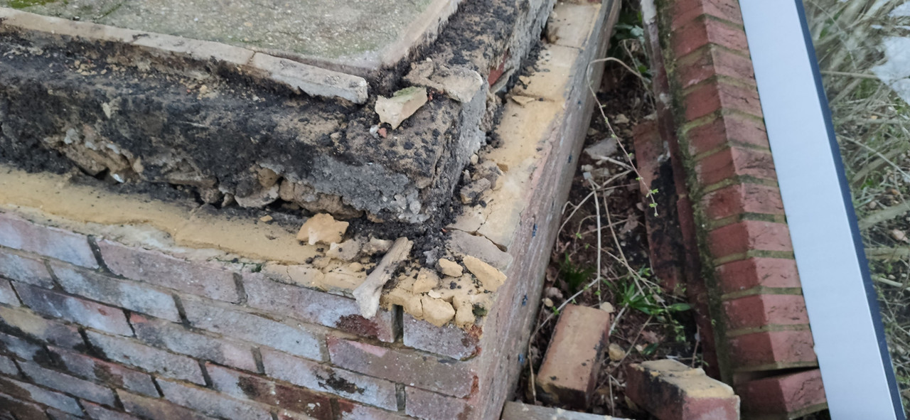

Now I am looking for a suitable builder to quote for clean up and repair. I suspect it will be more than £2,000 as the remaining bit of the wall is also damaged and I suspect it will all need removing and rebuilding along with the edge of the patio above.

Is that not a fence made of glass OP, would you even be covered?

They may well argue that the wall was not constructed to take the load of the fixing for the glass panels which look like they were retrofitted.
Posted : 21/02/2022 11:00 am

Oops WCA - that didn't work out too well then, although it's not really surprising TBH (putting all the twisting force onto a single 4.5" joint - shame you didn't fit into the concrete slab)

Balustrade, not fence. Fixings designed for the job. The rest of the balustrade - about 30m - had no issue. Yes - shame there was no concrete slab but given it has taken down 4 courses of brick and the keys into the concrete, I would suggest it was firmly fixed and that it was exceptional weather rather than poor installation.
Neighbours fences are down too and a few trees in the area so I think there is supporting evidence.

Posts: 1023
And the glass didn't break, fair to assume the rest of the installation was up to the job if the glass was spec'd well.

Yes – shame there was no concrete slab but given it has taken down 4 courses of brick and the keys into the concrete, I would suggest it was firmly fixed and that it was exceptional weather rather than poor installation.
I don't think people are suggesting that the fixings have failed. You can see from the photo that they have held on to the courses of bricks that they were fitted to. Just the thing they were fitted to (mortar bound courses of bricks) was an inappropriate thing to fix to. Mortar joints have no tensile strength.
That balustrade was unsafely designed, but better to blow over in a storm, than with somebody leaning on it.

Agree that it was the mortar joints that failed. The bolts going through three layers of bricks and across two of mortar with the wall tied into, and supported but the concrete patio to support it were considered suitable. The low fall height and lack of real use of the area meant ant risk of injury was small. Where it had been possible to inspect the lower wall construction - near the corner by the garage, it was well built and considered suitable.
Like the guys at the O2 who had their roof ripped off, I am going to put it down to extreme weather that exposed the weakness rather than a weakness that was inherent within normal, or expected levels of normality.
I'm not sure how you thought that the 4.5" brick (no row of headers) was tied into the concrete, but the fact that it's blown over doesn't show that to be the case.
