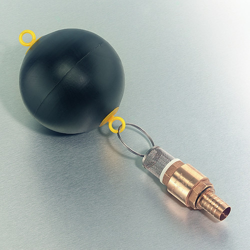

Push will work with a standard hose pipe.
Just get a standard submersible pump with a floating switch (so it auto turns off) and a floating intake.
