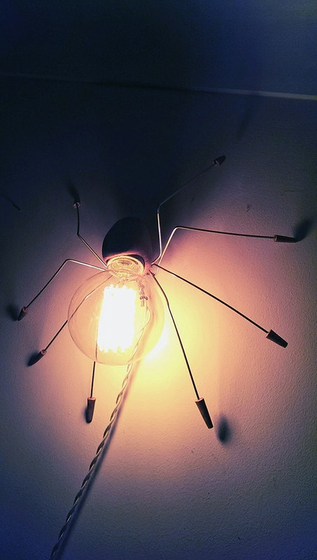

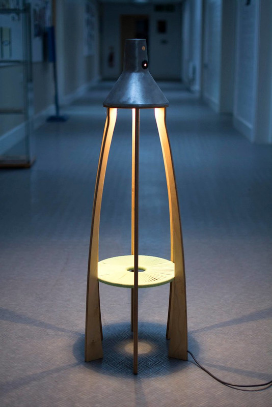

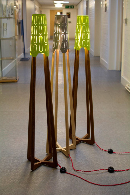

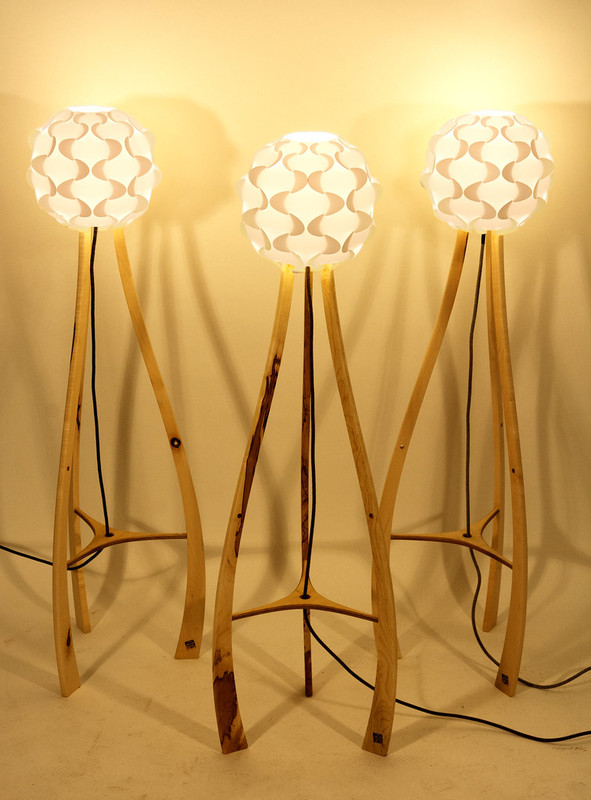

I've made quite a few lights over the years that I'd sell at galleries and exhibitions.
I would always get them Pat tested at a minimum. I would also seek some advice from an expert about earthing etc.
Some I would use Ikea table lamps, re-jig the electrics to take braided cord and make wooden bases.
I still got them Pat tested though despite using existing fittings.
Really cool lamp by the way. Talented lad 👍
Posted : 20/02/2021 7:23 pm
