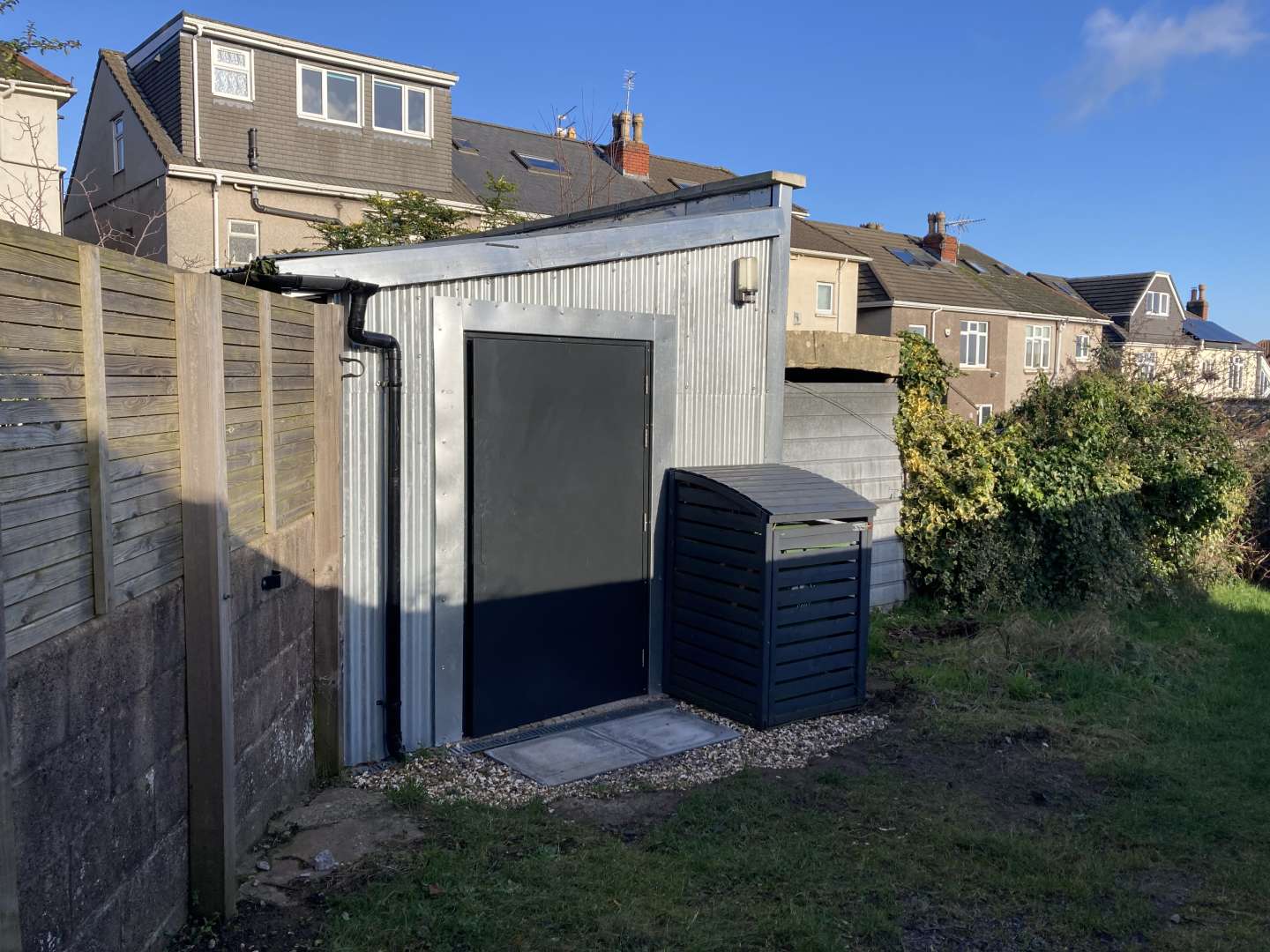

This is the back of my garage. 140mm timber stud with 10mm ply inside. Insulated and breather membrane and galvanised steel to outside. Latham steel door (highly recommended). For a more visible location you could timber clad externally.

1.2m wide and I could get a BMW motorbike through it.

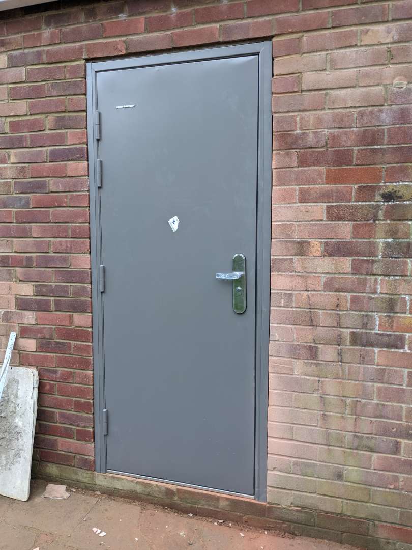

We removed the window at the back and replaced it with a steel security door (I think some places call them personnel doors).
I got one from doors security. One of these:
https://www.doorsforsecurity.co.uk/standard-duty-steel-security-door
It's not quite wide enough for decent width bars, but not really fussed about that. They do two sizes and I think I went with the narrower one. It was quite cheap compared to other ones; but it feels pretty solid.
They also do double doors.
Hopefully here's a pic just after it was installed. I'm pleased with it although in hindsight probably should have got the wider one.

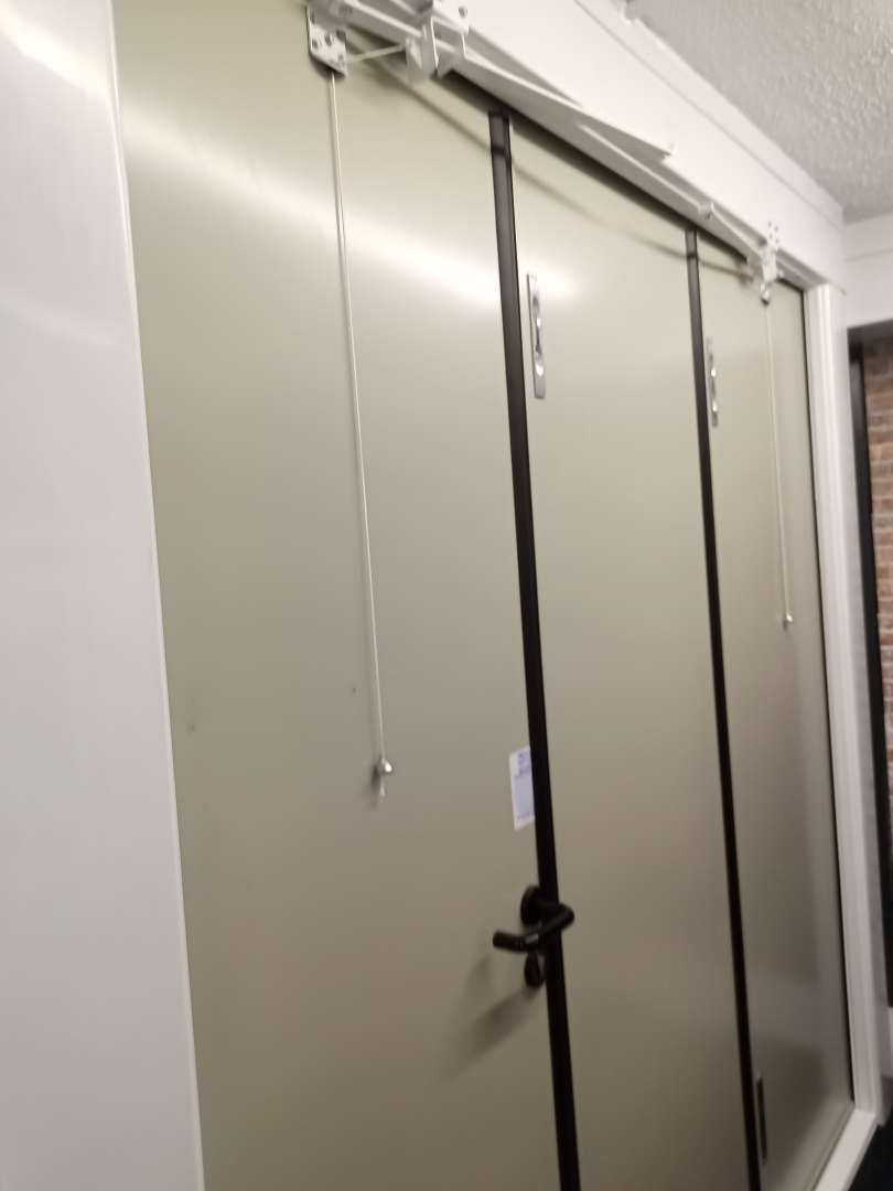

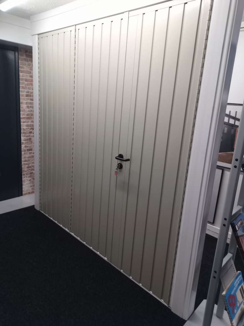

Posts: 3640
This is the BGID bifold in their showroom. I've included it as they do double bifold or even double trifold, giving one of the only side opening style doors that work with a big double garage opening.
