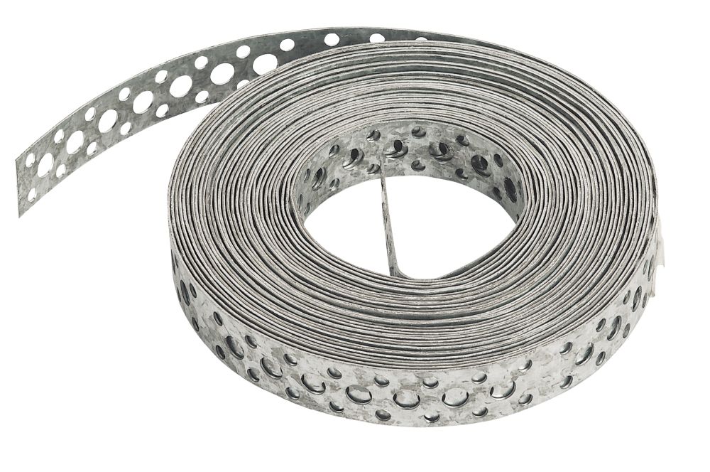

You could chisel out some of the old mortar and pack new stuff in. You could brace it with Builder's Band as well (looks ugly, but if you're plastering over it, so what).
[img] http://s7g3.scene7.com/is/image//ae235?src=ae235/38619_P&$prodImageMedium$ [/img]
You could take out 3 courses, stick in a pre-stressed lintel (£10 from builder's merchant) and then put back a decorative arch - but that's a lot of work a bit of piece of mind.
