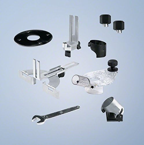

I have a couple, the one I use the most is a small 600W Bosch one..
[url= https://live.staticflickr.com/1562/23633177810_133b52d279_3k.jp g" target="_blank">https://live.staticflickr.com/1562/23633177810_133b52d279_3k.jp g"/> [/img][/url][url= https://flic.kr/p/C1odoW ]Untitled[/url] by [url= https://www.flickr.com/photos/brf/ ]Ben Freeman[/url], on Flickr
https://www.screwfix.com/p/bosch-gkf600-600w-electric-palm-router-240v/68002
Hunt around for the full pack, so you get all the adaptors, which are really handy:
