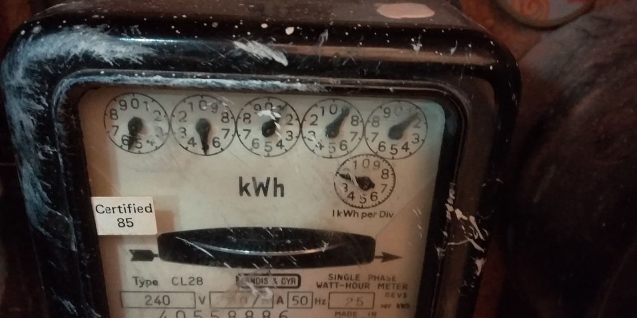

Posts: 17266
So I don't repeat the cock up of a few yearrs back I thought the grown ups should have a look.

Posts: 78299
55191, I think.

Posts: 23324
55191.2

Posts: 14
55191.2
No, it's only whole numbers only so ignore the .2
Linky

Posts: 8836
1.21 gigawatts
or what Cougar said.  AFAIK read each of the top five dials to the number lower than the pointer.  Did you receive a card with some instructions on? Does your last bill give you a clue as to what to expect?

Posts: 78299
Yup, same as the hour hand on a clock. The one underneath the others is a fraction and should be ignored when taking a reading, as BBSB said.

Posts: 818
is it not 55091
third dial hard to see, needle looks like its exactly on the 1 but the next dial is on the 9, so if third dial was to be read as a 1, wouldnt that pointer be closer to the 2?
always hated those dials used to take me ages to read them!

Posts: 17266
I'd love a new meter but no one knows how to fit it.
The reading should be 50912 going by our weekly usage.
If you zoom in on the 1 the needle is just before.

Posts: 2642
55091(.2)

Posts: 8836
is it not 55091
third dial hard to see, needle looks like it's exactly on the 1 but the next dial is on the 9, so if third dial was to be read as a 1, wouldn't that pointer be closer to the 2?
Absolutely correct, I'm swapping allegiance to 55091

Posts: 23324
good spot. I retract my earlier answer.

Posts: 14284
wouldn’t that pointer be closer to the 2?
Not if it only moved in 'whole' tenths (i.e. not gradually like an hour hand) Ahh, see what you mean.
Posted : 12/03/2019 11:00 am
Posts: 2642
Not if it only moved in ‘whole’ tenths
It doesn't.
It moves
Posted : 12/03/2019 11:05 am

Posts: 3675
Does anyone know why the hands alternately go clockwise and anti-clockwise? Is there a proper reason for it or is the designer a lunatic?

55091

Posts: 17829
55091.

Posts: 78299
is it not 55091
Ooh, good spot. You're right I think.

Posts: 78299
Opposing gears, I'd guess. </wild speculation>

Posts: 4209
In that case you have a problem; your bill is going to be £550-£600 more than you expect...
Are you sure of the previous reading your estimate of 50912 is based on?

Posts: 2642
All the hands are mounted on a train of gears with a 10:1 ratio at each stage so each one rotates in the opposite direction to its predecessor as per Cougar's speculation.

Posts: 9201
55191 to me.

Posts: 24794
55091; as said with the tens being nearly all the way through if the hundreds dial was really a 1 it would be almost at the two, as it is it's almost at the 1

Posts: 10980
55191

 kcr
Posts: 2949
55091
As others have pointed out, the 4th digit is definitely 9, which means digit 3 is about to tick over.
If the 3rd digit was already 1 and about to tick over to 2, the 3rd pointer would have to be almost at the 2. This is clearly not the case, which means it hasn't reached the 1 yet.
