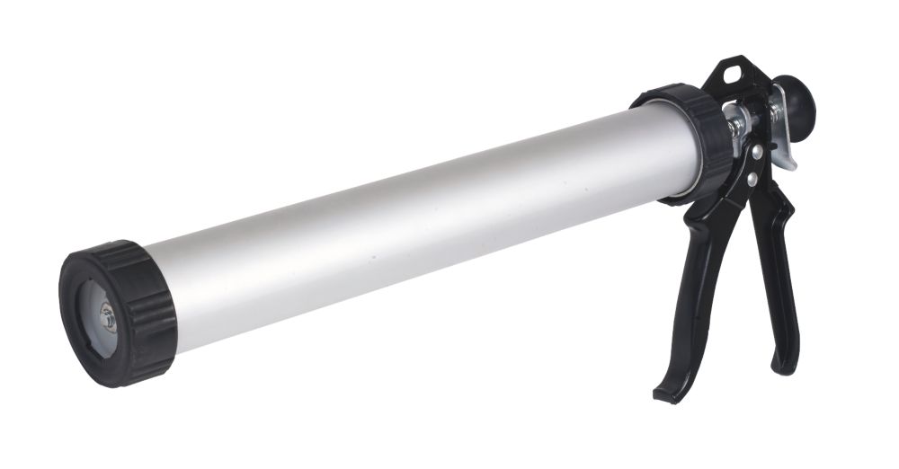

Posts: 10628
Get a mortar gun from Screwfix
[img] http://s7g3.scene7.com/is/image//ae235?src=ae235/67965_P&$prodImageMedium$ [/img]
Posted : 13/07/2017 4:13 pm
Posts: 1905
Thanks for all the responses above. Colour matching is not an issue as I'm not lifting the flags and this is just a patch up on a patio with a limited life span.. plus I'm going to do the whole lot as there's literally nothing left of the original mortar.
BigJohn - Do you think the mortar gun will work with such a dry mix? Or is the gun assuming I'm going to use a wet mortar? I think a wet mortar will be too messy for an amateur like me!
Cheers
Posted : 13/07/2017 6:28 pm
Posts: 10628
Wet mortar only. But I put up some brick slips (bricks cut down to make 15mm thick faces, round corners too to make them look like real bricks, but just a facing) in a kitchen, using tile adhesive. They're rustic faces but the mortar gun made a very tidy job of pointing.
Posted : 13/07/2017 7:14 pm
Posts: 6219
If you want to use a dry mix to avoid mess, make sure that the surface of the slabs has dried thoroughly so that you can brush it. Rougher surfaces will hold dry mix
I think that a wet mix will give a better finish, and the mortar gun should keep it all neat; the mortar gun has plastic nozzles that aren't obvious from the image ^^
Posted : 13/07/2017 7:18 pm
