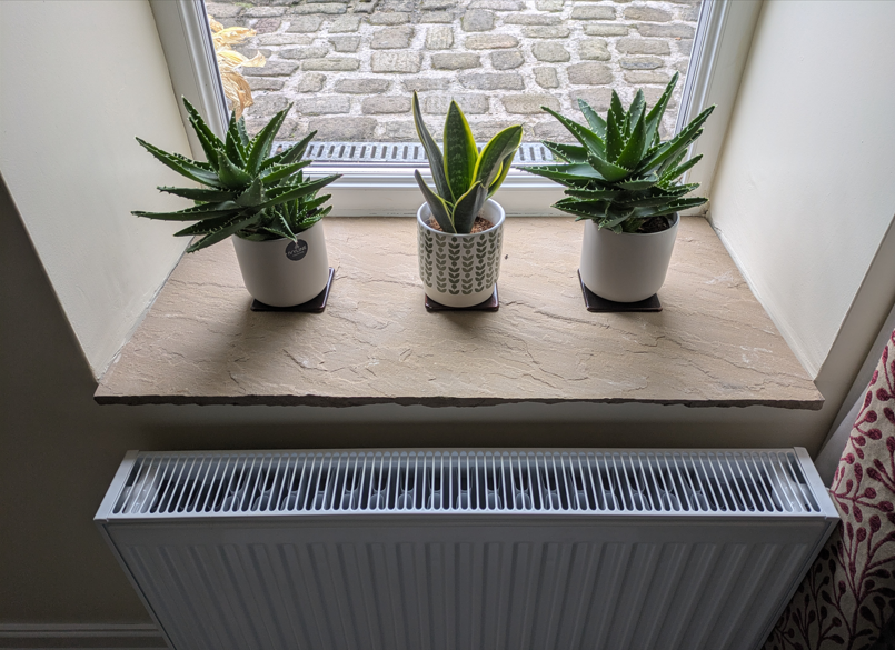

Posts: 20111
Thread revival time. After the purchase of an angle grinder and a fancy pants diamond disc, I set up my cutting table and my hosepipe again and had another crack at it and.......
ta-daaaa!

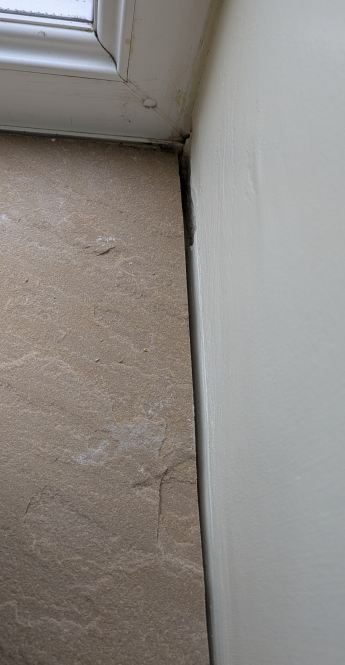

There are some gaps around the edges. It turns out that, although I'm impressed with myself for getting it bob-on the same shape as the old sill, the old sill wasn't a great fit. I'm all for leaving them (to let it breathe a bit, cos of the damp issues that got us here in the first place), but MrsIHN would prefer them filled. Rather than bunging it up with silicon, is there a breathable gap-filler that looks decent?
A gap earlier...

Looks nice.ย
For the gap filling, I might go with a small wooden bead painted to match the walls if you don't want it sealed. Which sounds like a sensible approach.ย

Hmm, beading eh...

You could try for a matching tile grout, just don't smear it everywhere so use some tape
Otherwise, a bead or flat strip (rather than a more trad glass bead) on the wall and painted white. The problem then is that you'll have gaps under the flat bead ๐Ÿ˜‰ https://richardburbidge.com/shop/mouldings/windows
Posted : 04/09/2025 10:32 am
Posts: 20111
Posted by: timba
Yeah, good point.
What about good old boggo Polyfilla, is that breathable?
Posted : 04/09/2025 10:44 am
Posts: 6623
I'd leave it as is. You can only see the gap because you know about it; nobody else will notice. White filler will look like a poor paint jobย

First time ive seen this thread. looks brilliant, considering you were going to cap some crappy fibreboard.
well done!
ย
If it were me, i would leave that gap. Its hardly the grand canyon, you wont even notice it in a weeks time, and it lets the damp breathe better?

Someone has noticed, and I'm married to her

Nice job. Unlikely that any of your surrounding materials are breathable - emulsion and UPVC windows. I thinkย  you are asking a lot of a tiny bead of filler to provide much in the way of moisture transport. What did you bed it in with? I'd just use whatever filler you have.ย
Oh, don't get me wrong, I'm not expecting this to fix the issue, but if I can avoid trapping any (more) moisture under there then that can only be a good thing.
Nothing, it's loose, just sitting on the splats of dried grab adhesive that the old one was stuck down with. Well, I say 'loose', it probably weighs 20kg so it's not going anywhere.

If you really want breathable you are probably looking at lime based, you could try a casein filler - https://www.limestuff.co.uk/fillers/volvox-filler-500g-565

Looks really good.ย  I would run a wooden bead around the edge if it were mine
