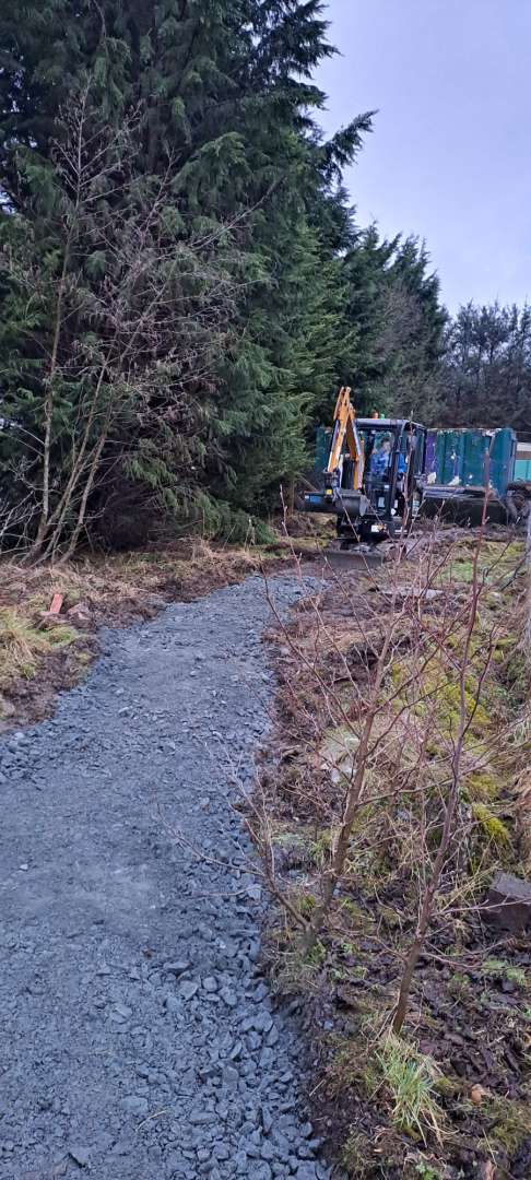

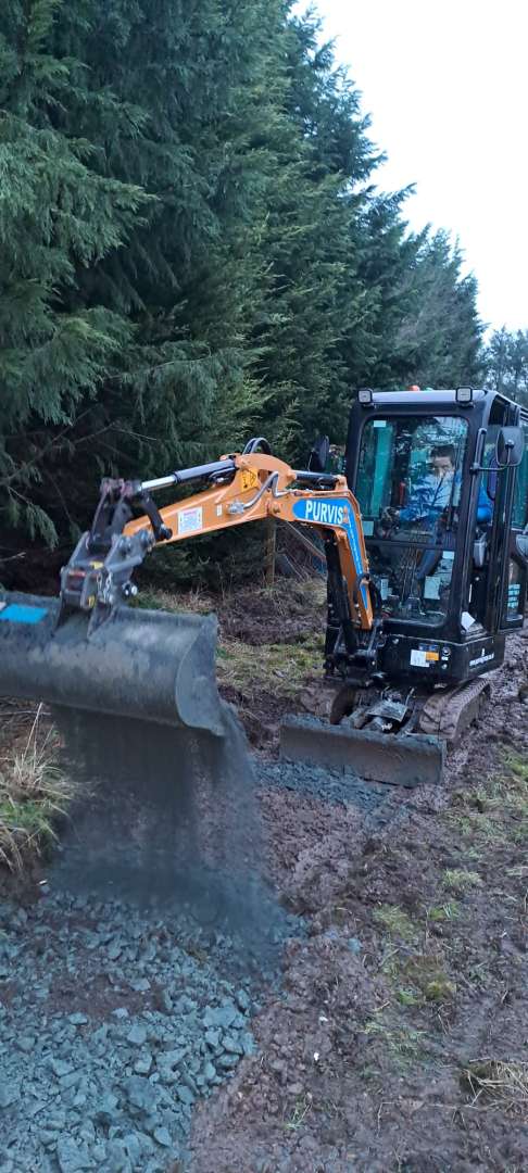

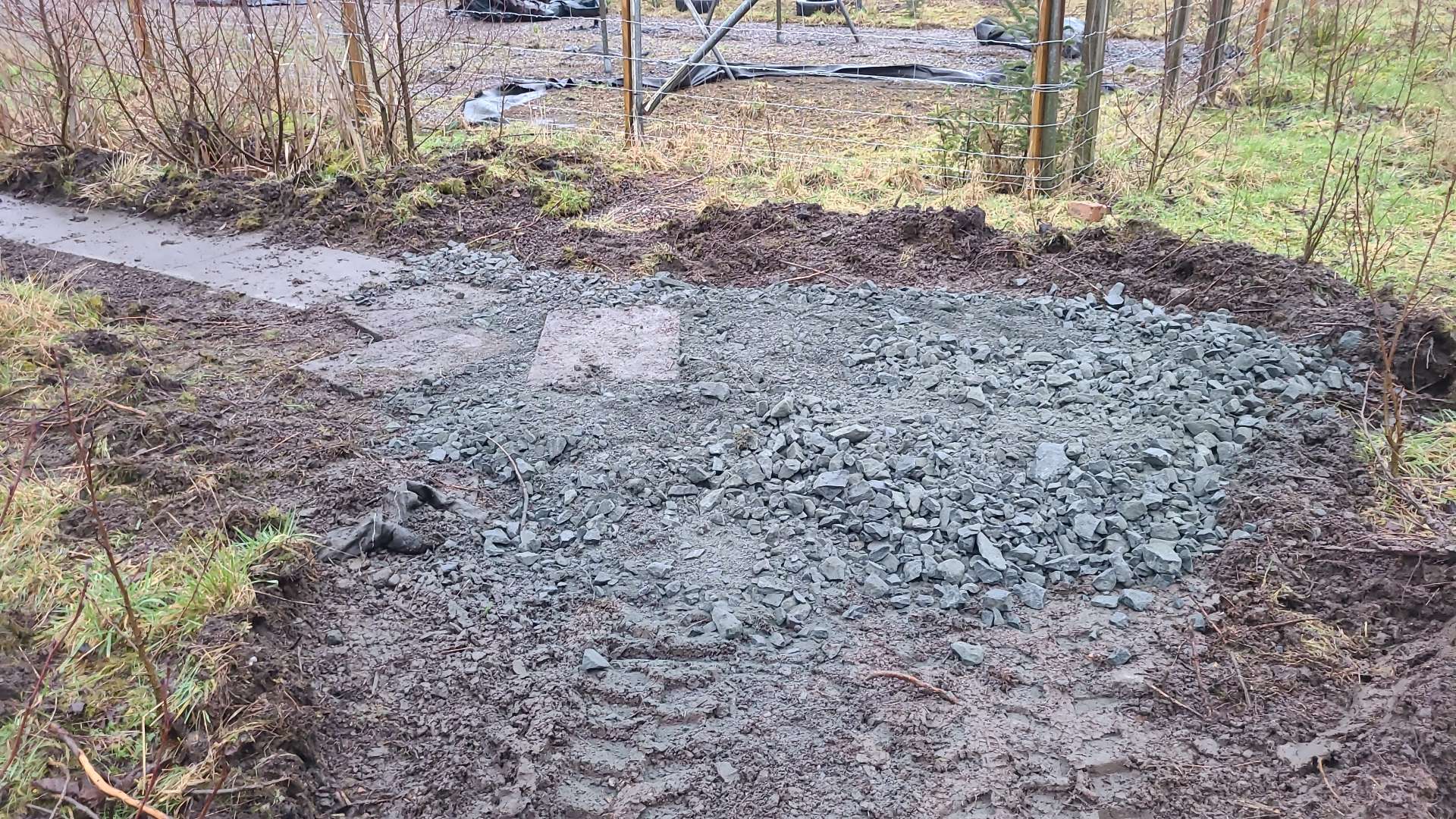

Thanks for the advice folk.  It all went well tho hard work.  Under the top layer of moss and weeds was gravel much to my surprise so a dig down to the firm gravel layer and build up with dusty type one seems to have done it,.  I'll get some pics
Posted : 10/02/2026 11:20 am
Posts: 44676
IMG-20260210-WA0003.jpg IMG-20260206-WA0002.jpegIMG-20260210-WA0003.jpgIMG-20260210-WA0002.jpg some pics of my labours.   its not going to take too much traffic

Looks good
.... And you got to play with a digger 😉
