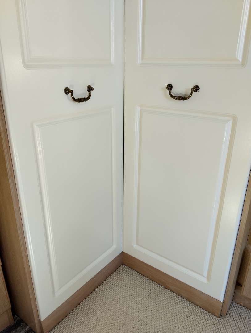

Posts: 1775
Our spare bedroom was completely fitted out with cupboards and drawers in beige wood effect plastic. The coloured plastic skins started to delaminate so we peeled them off and painted an off white colour. Looks good, well much better than wood effect plastic IMO.
They do look painted, so obviously brushed of rollered on rather than the perfect flat skim of usual kitchen cupboards.
We used Johnstone's cupboard paint which is relatively cheap. Sorry for the poor picture. Difficult to get a tall narrow cupboard in one picture.

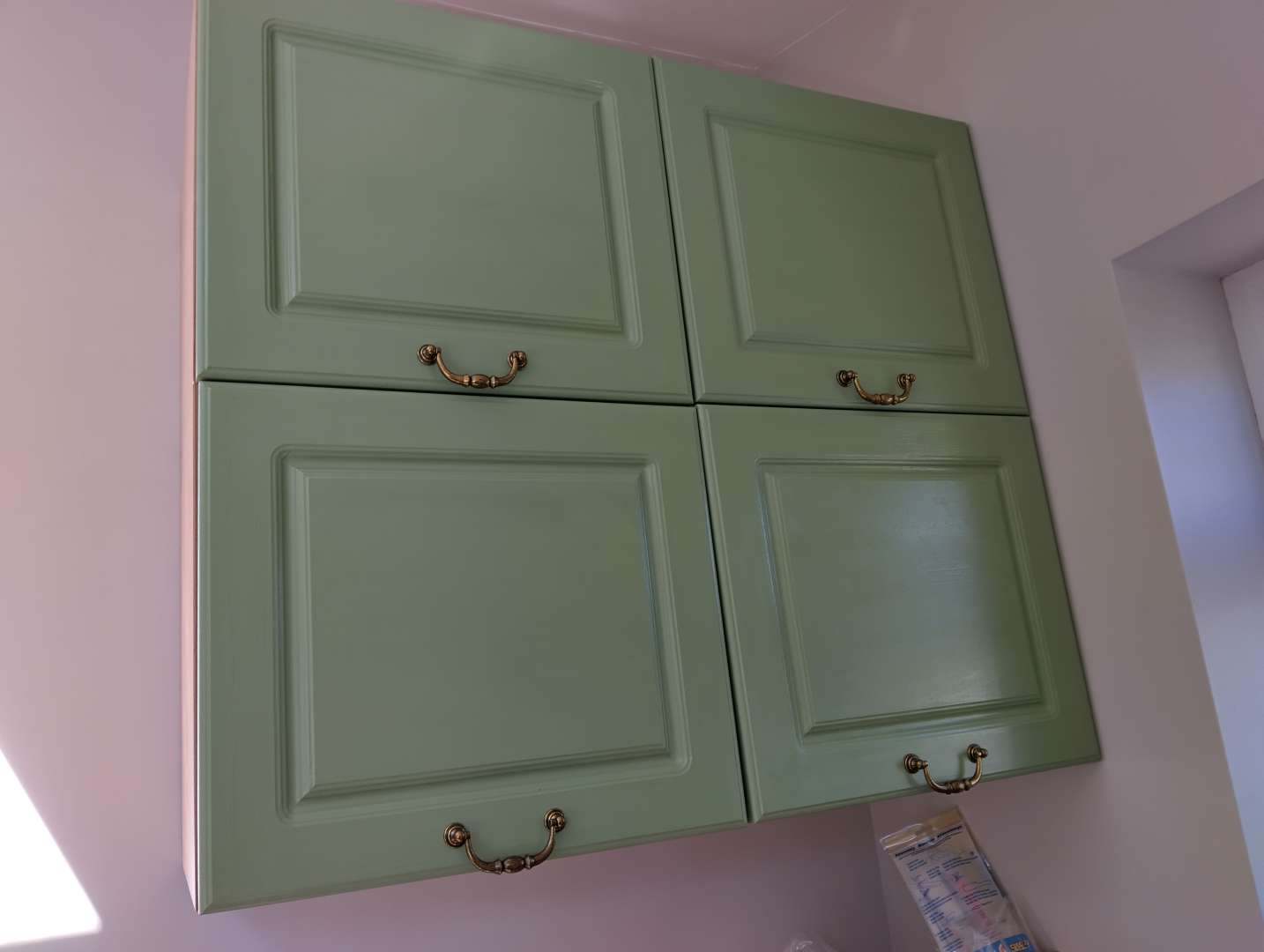

Also reused the top cupboards that used to go over the bed in the utility room but painted green to nearly match the other cupboards in there. Not a 100% perfect job but loads more tool storage for minimal outlay.
IMG_20250401_141036_HDR.jpgPS cupboard style may not be first choice but we couldn't afford to replace 3 large corner cupboards and drawers between in the spare room. It's really useful storage.
