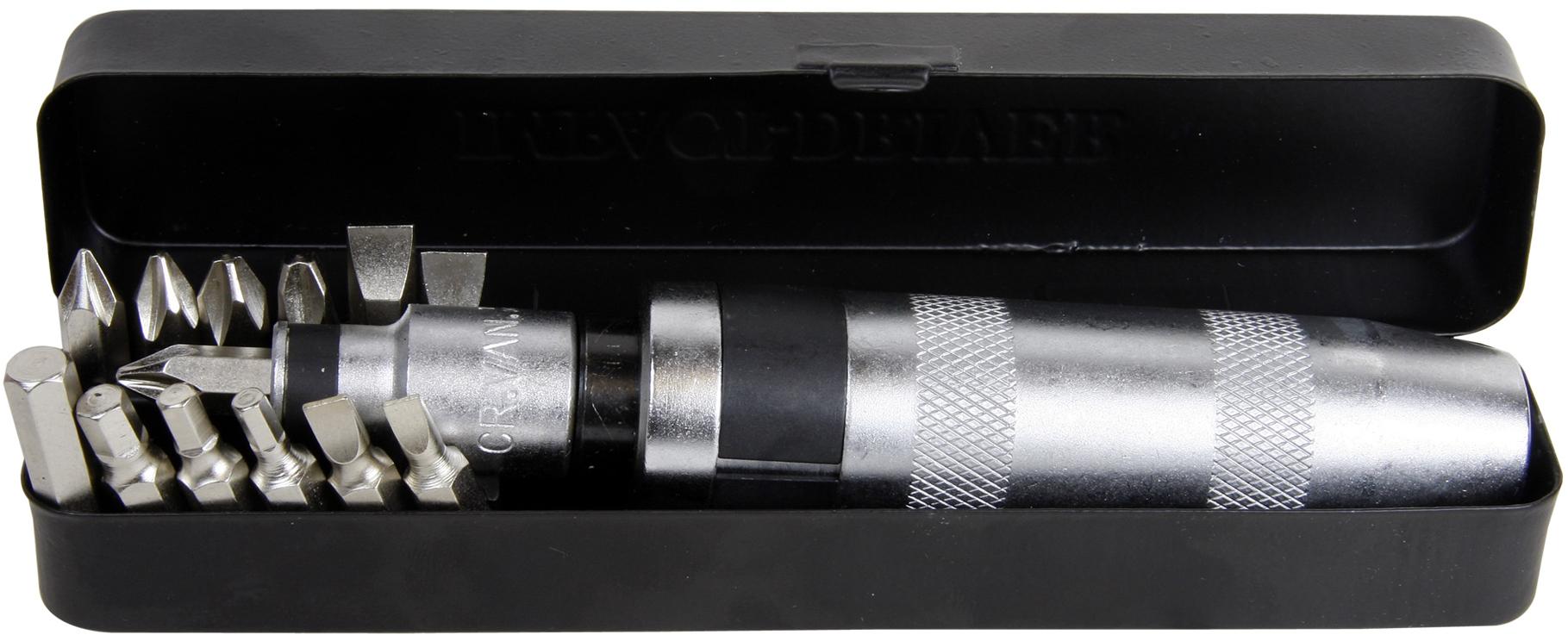

(by the way, anyone know how to remove a stuck showerhead screw?)
In the past I've resorted to an impact driver and a big hammer - something like this [img] http://i1.adis.ws/i/washford/926881?$imageMainRetinaMobile$ [/img]

Thanks, Onewheelgood. I'll have to get one of those. Access looks difficult from below, so presumably you remove the boiler unit and do it "outside" of the chassis. Thanks for the tip.

My machine (about 15 years old) has OK access from below, so I just removed the drip tray and the reservoir and turned it upside down.
