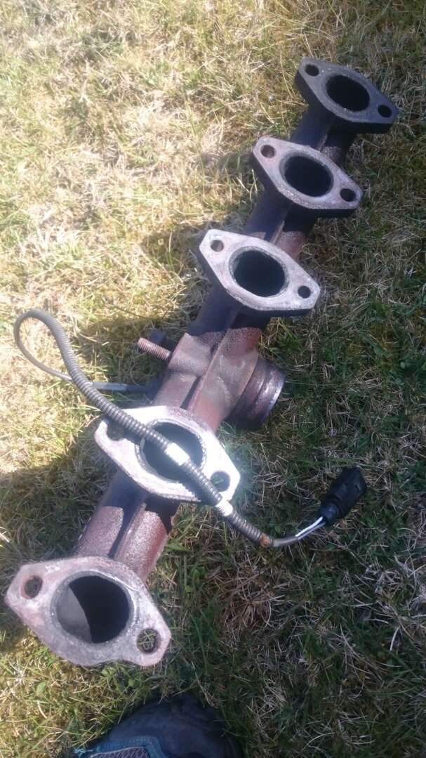

I also have a 2.5 T5 on 175K miles. i get a whistle just as the turbo kicks in, I quite like it.... but might need to investigate further now. also fumes on tickover have returned had the manifold gaskets done and a mashed bolt replaced a year or two ago which cured it but its back, from what i've read they are prone to cracking manifolds which leads to fumes? anyone else have any clues on this?

Smoke test basically uses a smoke machine with an expanding plug to fill the system with smoke. Then you just look for where it's coming out. In practice I don't know if it matters where you attach the machine to test certain parts. Guess the air intake would be a good start?
As for the manifolds. The 'A' series engines have stainless manifolds that can split. The 'B' series engines went to a cast manifold which won't split, but can warp and pop the manifold studs. Mine is a BNZ engine with the cast manifold and I *think* the studs are all good. I've had a look with a torch and an inspection mirror and no sign of soot so think my issue is the turbo manifold gasket which is a common issue especially with a DPF as the back pressure can cause the gasket to blow earlier.

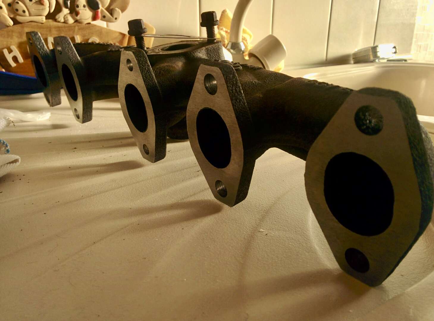

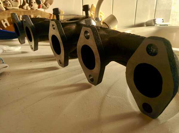

Mine wasn’t cracked but had warped so I got a local engineering firm to skim the mounting faces which I think cost me £50. I had to change my turbo as well at the same time.
It ran great afterwards and no more fumes in the cab.

Thanks for that info, very helpful from what you’ve said it sounds like mine had warped as two of the studs had to be replaced when they did the gasket I’ll check in the morning whether it’s cast for definite but now you’ve said that I’m pretty confident it is!
