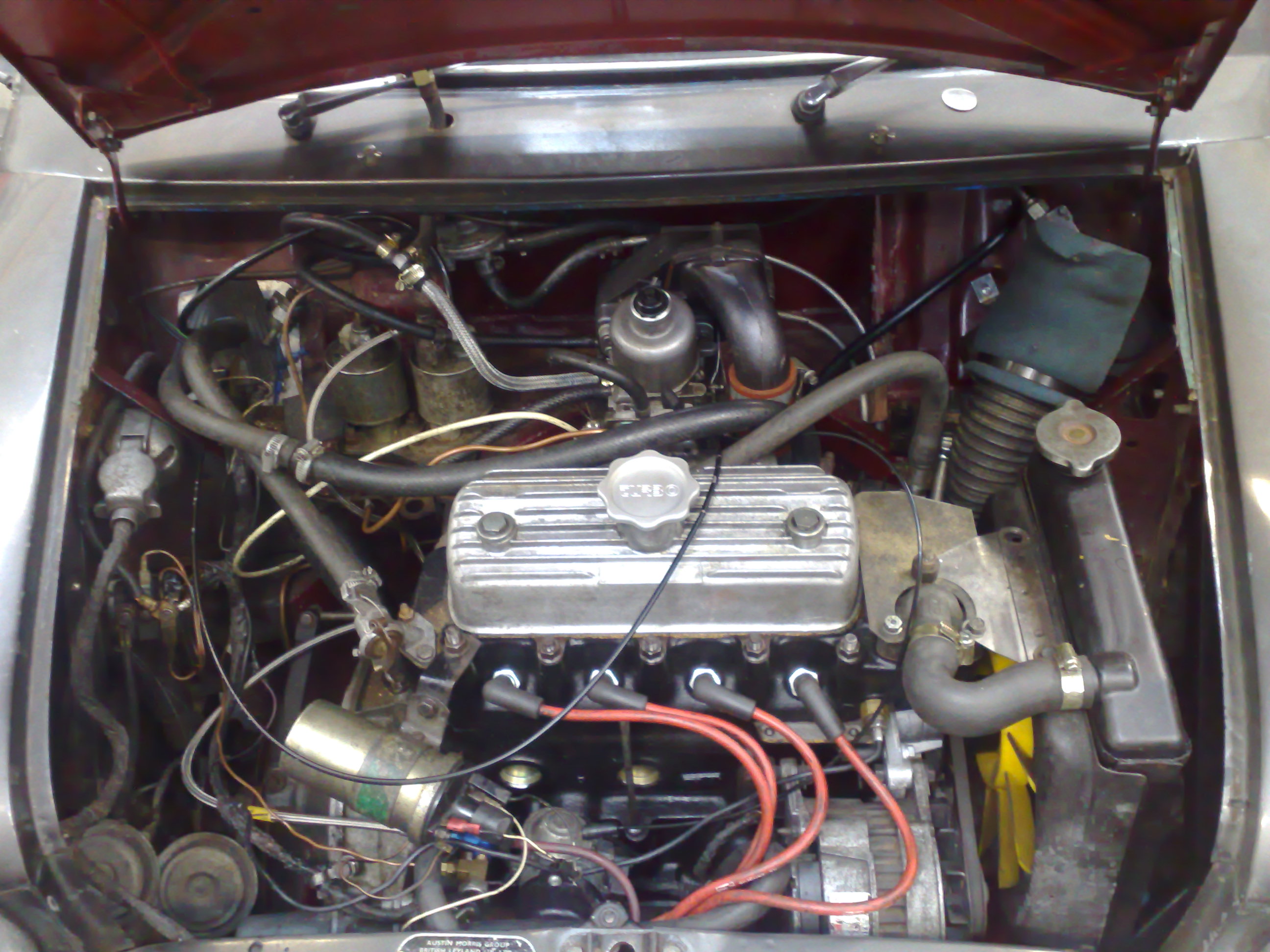

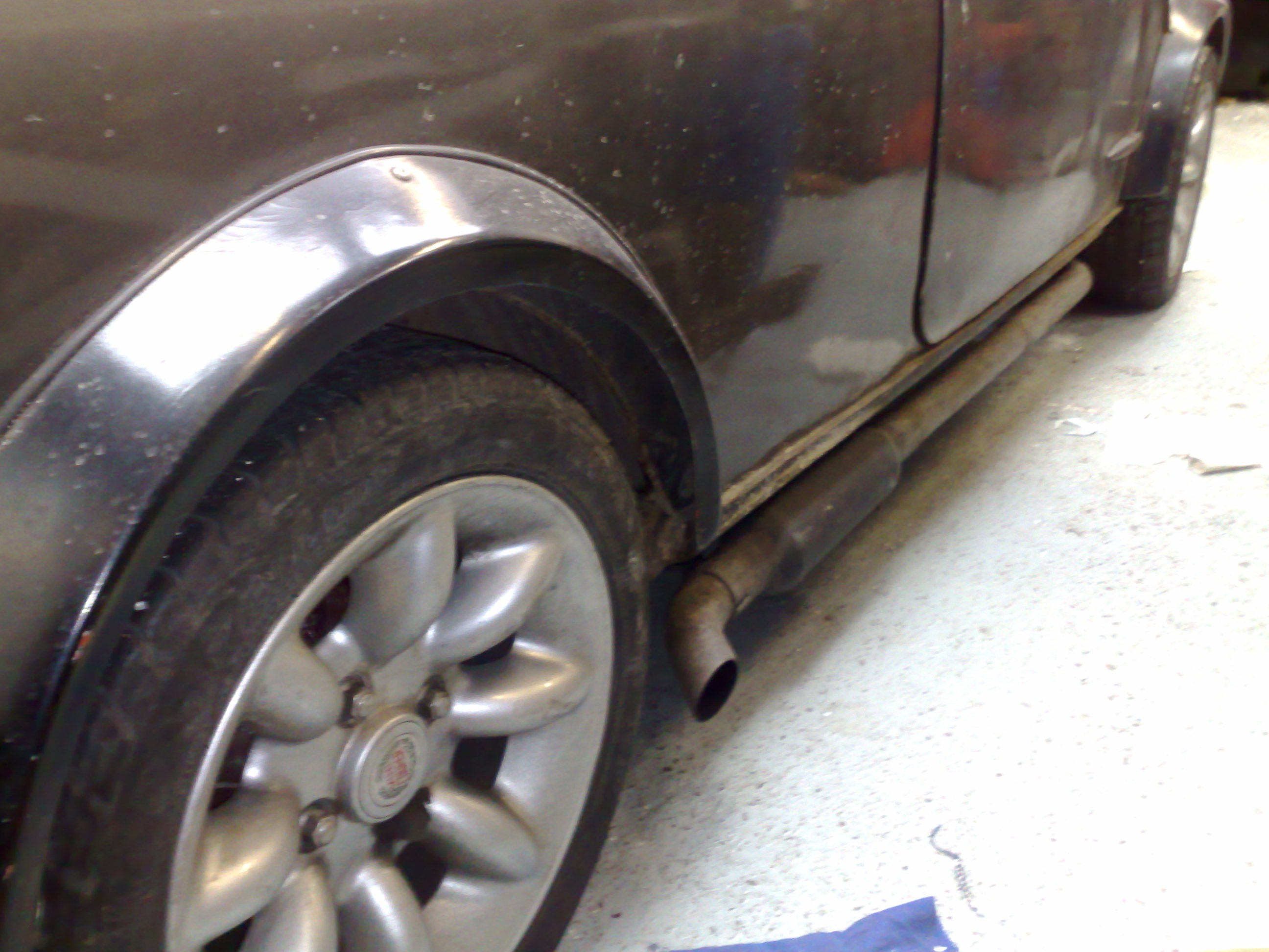

Nonturbo at the moment
Now the diff and suspension are all set up in it's mild-ish form, the engine will have a few internals refreshed and Turbo which it was built around is going back on, should be a reliable 280BHP 😈
OP not sure if it's the same model or problem but I seem to vaguely remember some of the BMW Mini's had turbo problems because of the oil feed pipe being run somewhere which got a nasty hot spot so it got coked up and restricted flow, killing turbo's. I could be wrong, might have been another car I'm thinking of, not 100% it was mini? but a re-routed pipe or heat shield would fix it (obviously for BMW to do) have a google around to see if you can find anything similar.

Agreed tbh, it's my brother car, it's about 180BHP and is very! fast as is, but surprisingly drivable. It's now as much a show car\advertising for what he's doing for a living, only been going a few months but has got plenty of work already. He's got a few complete restorations in (Mini, Morris Minor and a beetle, amongst other smaller jobs) and is taking on extra staff already.
really proud of him, starting out from nothing after being made redundant and making a great success of it.
Sorry OP, I still think your problem is oil related though i.e. lack of, not necessarily complete loss but not sufficient flow causing premature bearing/seal failure in the turbo
